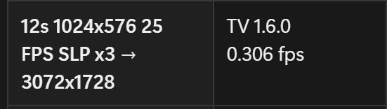

Retested with RTX 5090 under TV 1.6.0 version

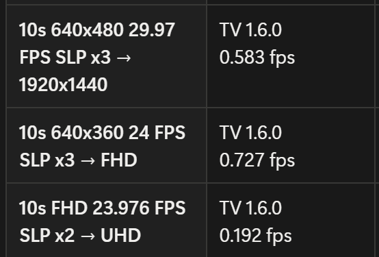

In 1.5.0 my test clip took 39 minutes to complete. In 1.6.0 it took 10:59. That’s with my RTX 3080 Ti. On the computer with the RX 9070 XT, it took 54:49.
