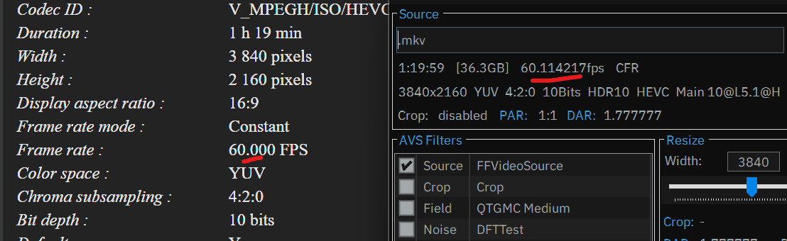

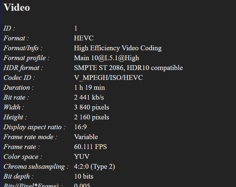

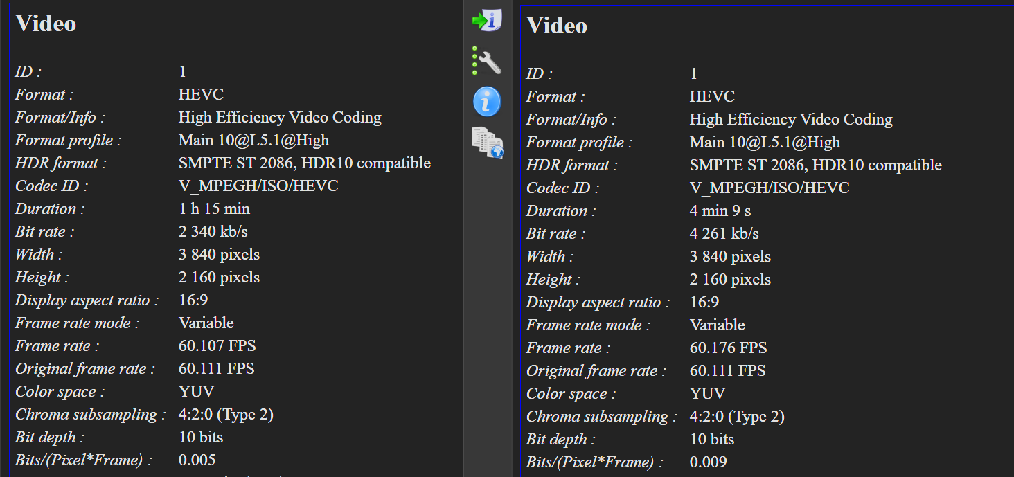

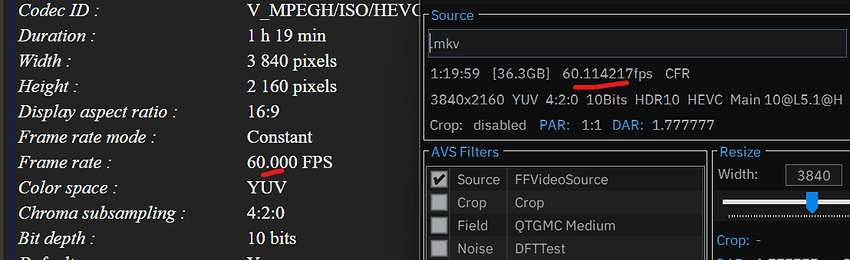

How is frame interpolation still borked a year later?
The interpolated output “may” initially show constant 60fps, but when doing a further compression ensuring to use the timecodes from the “constant 60fps” video it tells a different story in the output..
Sure, its close enough where you could disregard the correct timecodes, force constant 60fps and be unlikely to notice any obvious A/V sync issues, but its still not correct compared to v5.3.6
This issue seems to be a very low priority, if any, for developers. Like I mentioned in the past, I lost my hopes long time ago to have this fixed. That’s why I still use v5.3.6 for interpolation, even though even that one is not perfect because it creates some random artifacts, especially on fast pano movements of the cameras or high speed action scenes.
Deleted

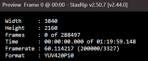

Wait…Your compressing the output from Topaz in another program, and that program exports the video as variable framerate?
Correct. When setting “extract timecodes” to “always” in Staxrip, FPS metadata in output is adjusted accordingly like in the above example to 60.111fps (as well as retaining A/V sync since timecodes are correct in this case) which does not match the metadata that TVAI initially shows. If metadata matched timecodes then the FPS would be 60fps for both input and output regardless of whether I used timecodes or not, like with v5.3.6 and prior.
Using timecodes like this can often change the metadata from constant to variable given how very small decimal place differences (in timecodes vs expected 1/60 calculation) are flagged, so isn’t reliable at detecting variable FPS.. however.. splitting that same file into 2 parts and rechecking metadata shows a slightly different FPS for each file, so yes, the result is still variable FPS.
Staxrip atleast (without timecodes extraction) identifies that the FPS is not 60 because it does its own calculation of frames/length, but not sure why it only calculates using the first 200k frames though :thinking:
Calculating based on total frame count and length in seconds…
288497 / 4799.148 = 60.11421193928589 (average) FPS for a supposed “constant 60.000 FPS” TVAI output.
Using the default treatment of timecodes extraction (of extracting only when VFR metadata is detected, which many other editing software also follow), they would get discarded since TVAI output is incorrectly labelled constant 60fps, resulting in your newly edited or compressed file having the A/V going in and out of sync throughout the file. Of course, YMMV depending on your TVAI workflow, how you handle the TVAI output and if there’s any additional processing it undergoes etc.
I presume you’ve checked the integrity of the source files frame timing?
Yeah. Frame timing of the various source files I’ve tested is fine. The majority of them are 1080p remuxes in 23.976fps. 5.3.6 works fine for interpolating them, but has issues with some models having artifacting.
To fix an issue in the app, we have to be able to replicate the situation consistently so that the devs can understand what is causing the issue. This can take time to sort through, especially with complicated issues. Getting logs from users who are experiencing the issues can help speed up this process.
In the case of the situation you are seeing, it took a while for me to even replicate it and sort through the data to find that it only happened when using videos that were smaller than a certain resolution size and when the app was seeing them in non-square pixel format.
Our support team, the devs and everyone at the company cares about issues in the app and want users to have good experiences with our apps. There have been multiple changes since 1.0.3 and even before that release, that could be contributing to this issue as all of them are being reviewed to sort out what is going on here so that it can be fixed.
In my comment above, I stated I was able to replicate the situation with a file, and then by converting the file to a square pixel format, I was able to use the model as expected. Have you tried this approach and still run into the issue? If so, please send us the logs so we can continue to look into the situation.
The Devs can reproduce this inhouse without user logs. VFR or fake VFR exists since the change to mplayer…there were fixes, but was never 100% fixed, V5.3.6 is the latest VFR free version. To reproduce, take any video, i recommend 29.97 or 23.976 then it happens every time. Do frame interpolation from 23.976/29.97 to for example 60fps, keep “replace frames” on…result is VFR.
But it could also happen (not every time) when source is 30fps and output 60fps, you may can can see small difference in fps as described above, for example 60.1 fps out, maybe you can see it after re-encode or remux.
