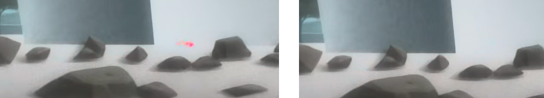

Has anyone had an issue with some of their outputs having partially corrupted frames like below?
Some of my outputs have red blotches (left example vs right which is a few frames apart) at random parts throughout for a second or two, both for my Nvidia rig and AMD rig. Same models etc which didn’t have this issue with 5.3.6 on either card, compared to since version 1.0.4 (rarely used any version other than 5.3.6 till now, so unsure which specific version it would have started at) and now 1.2.0 (same models but with new grain) where I’m occasionally getting these corrupted frames. Reprocessing the same file either results in a clean output, or the corruptions in a different place.
Bonus points if anyone has a workflow to replace certain frames from one clip with another, without re encoding, which would help avoid redoing the entire TVAI export.
That’s impossible, but I have my script setup to use tiff images as the intermediate format. With that, I sometimes do modifications to the frames before running the next AI pass or the final encoding.
oh sweet, yes, tiff images, may do the trick for future exports thanks.
Regarding swapping out specific frames or portions of a video without re encoding (specifically the entire file) being impossible.. I’d be surprised if this was the case.
Using chunked encoding as a rough example, you can encode portions of a clip separately, often using different CRF values (such as with Av1an) and then mux the encoded parts back together into a single video file at the end.
Taking that process into account… it should be feasible to split this exported file into portions, separating into clean parts and corrupt parts, taking note of the frame range(s) for the corrupt parts and doing a re-export (from source) for those specific frame range(s) in TVAI and then muxing the clean parts from original export with the replacement parts.
I suppose you might be able to get that to work if you cut on key frames. I use ffmpeg commands for all my video editing. It would probably be a lot easier with a more normal video editor.
