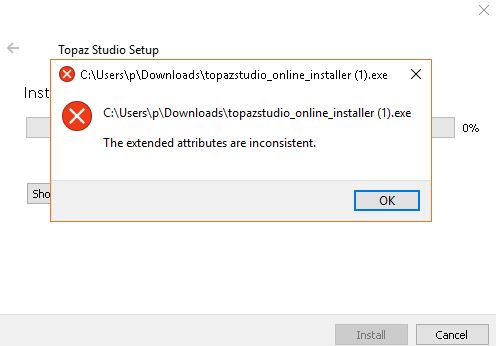

Hi, Previously had a problem with my Wacom pen working with the trial of Sharpen A I so un-installed Sharpen A I but the tablet then would not work at all on anything so after days of trying this and that I found a solution , Updated my system drivers from the original install CD now everything works except Topaz Studio software, I un-installed via the windows option in device manager, re downloaded the software but it will now not install and I get the message as in the attached screen grab. Thankyou for any help. Russ.

Make sure that the installers are downloaded from the Topaz Labs web site but that seems like a UAC error so there may be an issue with your system. This is a error that can mean issues that include registry errors, fragmented files, excessive startup entries, hardware/RAM decline etc. What you can do is try this:
  • Right-click on your Windows icon on the taskbar and select Windows PowerShell (Admin)
  • Type sfc /scannow on the command line and press enter. That will check for any system errors and fix then.

Thankyou the sfc /scannow seems to have fixed he problem. Russ.
