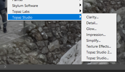

Snip of Ps CC 2019 Filter Menu (plugin BUG that wiped out plugin access to TS 1):
@Fotomaker I have TS 2.0.9 installed and still have access to both in PS CC (Win 10)

So, until this 2.0.9 vers. I saw all the same filters you show in your snip (Clarity, Detail, Glow, Impression, Simplify, Texture Effects) but no listing for Topaz Studio.
If I clicked on one of those filters it, at least, took me into Studio 1 in a not very direct way. But I could at least get in and work with it.
Something in the latest revised code wiped out all the other listings that were there.
My suspicion is they need to correct for those of us running Win 7 PCs. We can’t be w/out Studio “classic” if we paid for it and need to use it as a plugin.
