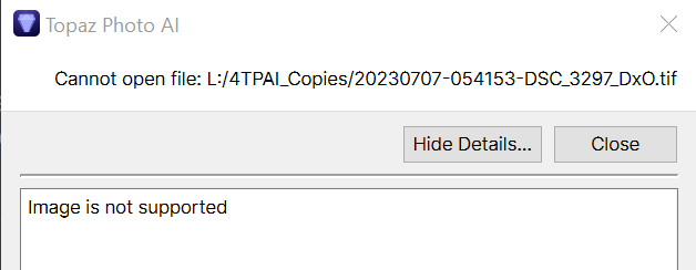

Thanks for the reply. Good to see its working on Windows. Yes, I’m on a Mac. I provided a dropbox link to a TIFF file exported by my copy of DxO Photolab on the TPAI v1.4.0 release post. It would be good to know if the Windows version of TPAI v1.4.1 will open this TIFF file.
Thanks again!
The DxO TIFF does not open in Windows TPAI unless I open it in Photoshop first and resave it without editing.
The only difference I can see between the two files is that your original has X and Y Resolution shown as 9830400/32768 and the Photoshop resave has it as 3000000/10000. Both equate to 300 dpi so I don’t know why that might be an issue in TPAI.

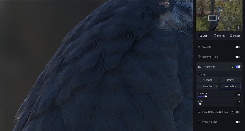

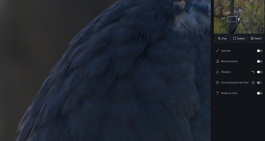

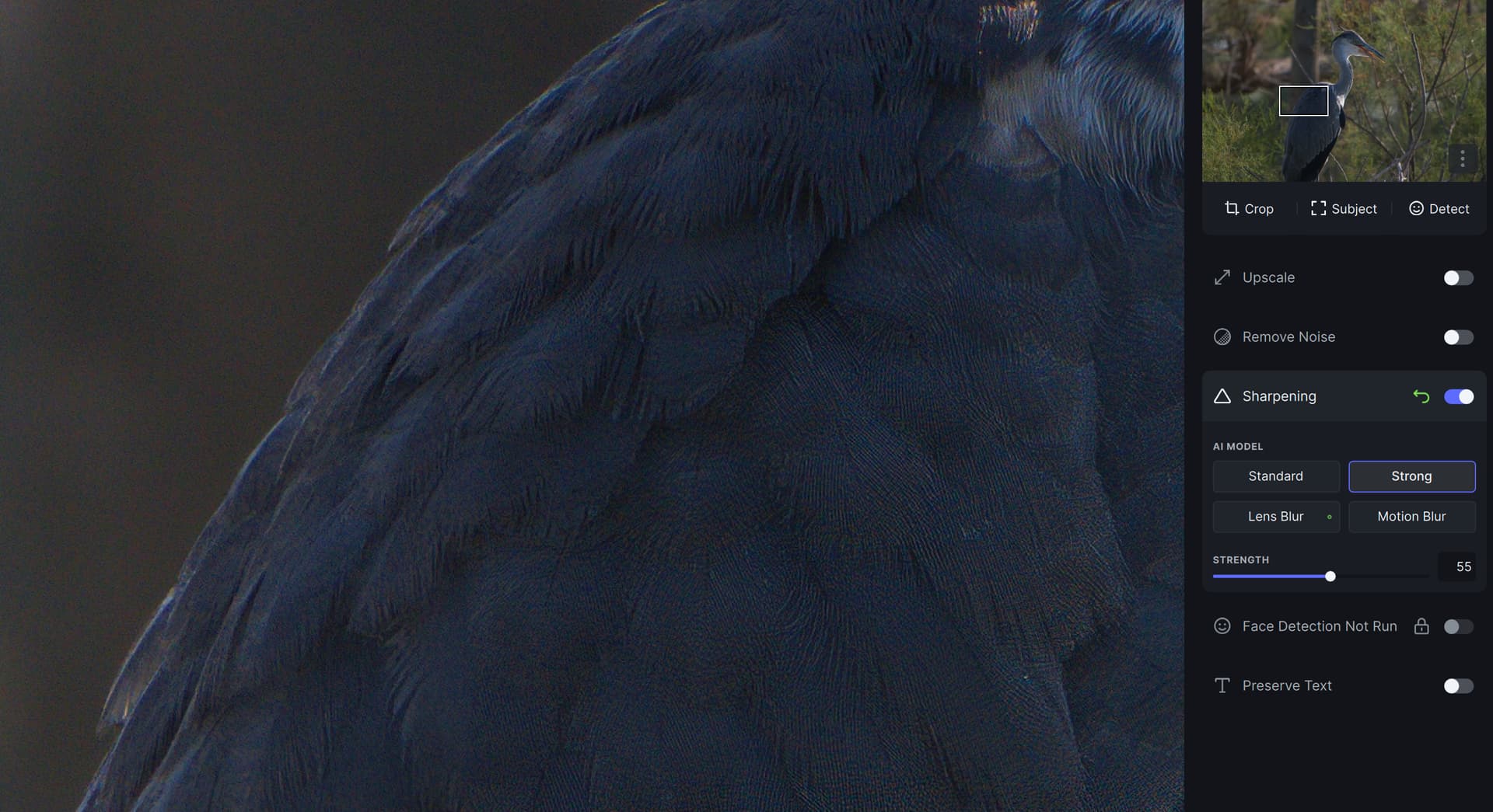

This is common artifact with feathers.
Unprocessed:
Sharpen/LensBlur:
Similar with Sharpen/Motion:
Sharpen/Strong seems to be on the right track here
There is, however, overall increase in image brightness:
It doesn’t crash but I assume I get what you get:

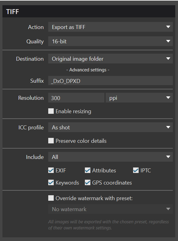

Here’s my TIF saving settings:
(The suffix varies.)
Do you see anything different?

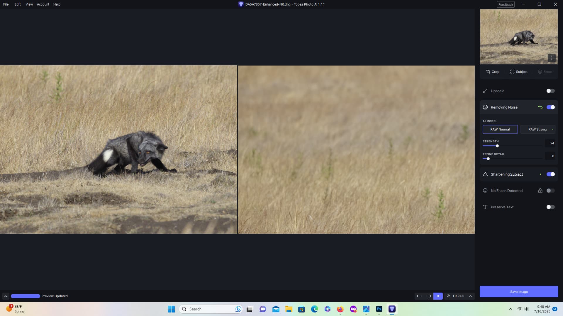

Not even sure what the heck is happening here. I usually have some issues with TOPAZ AI and wildlife - generally but this???
Win 11 Pro desktop PC. Ps 2023 Plugin. Processor = AMD RX6800 XT. All A.P. set to None except Sharpening detect.
Working with .tif image (previously unprocessed… but tight-ish crop from Sony RX100 VII shot.

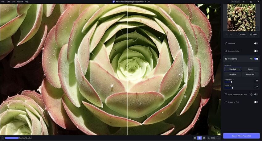

I’m sad to say I cannot use this 1.4.1 release for any of my photo processing. I’ve tried a number of images of nature, scenics of various ilks, text, people (whom I rarely photograph_) and none of them are processing to deliver a level of sharpness, clarity or accuracy I can use. They all seem to have digitized (blocky worms)/pixelated artifacts on the surfaces of objects and the edge & detail sharpness is not at a level it should be relative to the original images.
B/c I test, I try various permutations with manual settings (after checking out where A.P. has put his little green dots). Meaning… I try all the various models (when I don’t get a satisfactory result), alter slider adjustments for the models, try adding denoise if no denoise was proffered, ditto I’ve tried enhance (obviously w/out upscale b/c I’m using the Ps Plugin). In other words, I don’t just look at what A.P. plunks onto my display and immediately throw in the towel. I try to actively achieve the look I desire. I’m not successful with this release. I’m getting very frustrated!
Here’s just one example from various attempts - I posted a really awful result (with the Breguet watch) above already: (again, this is one snip of one setting - I’d already tried other settings combos)

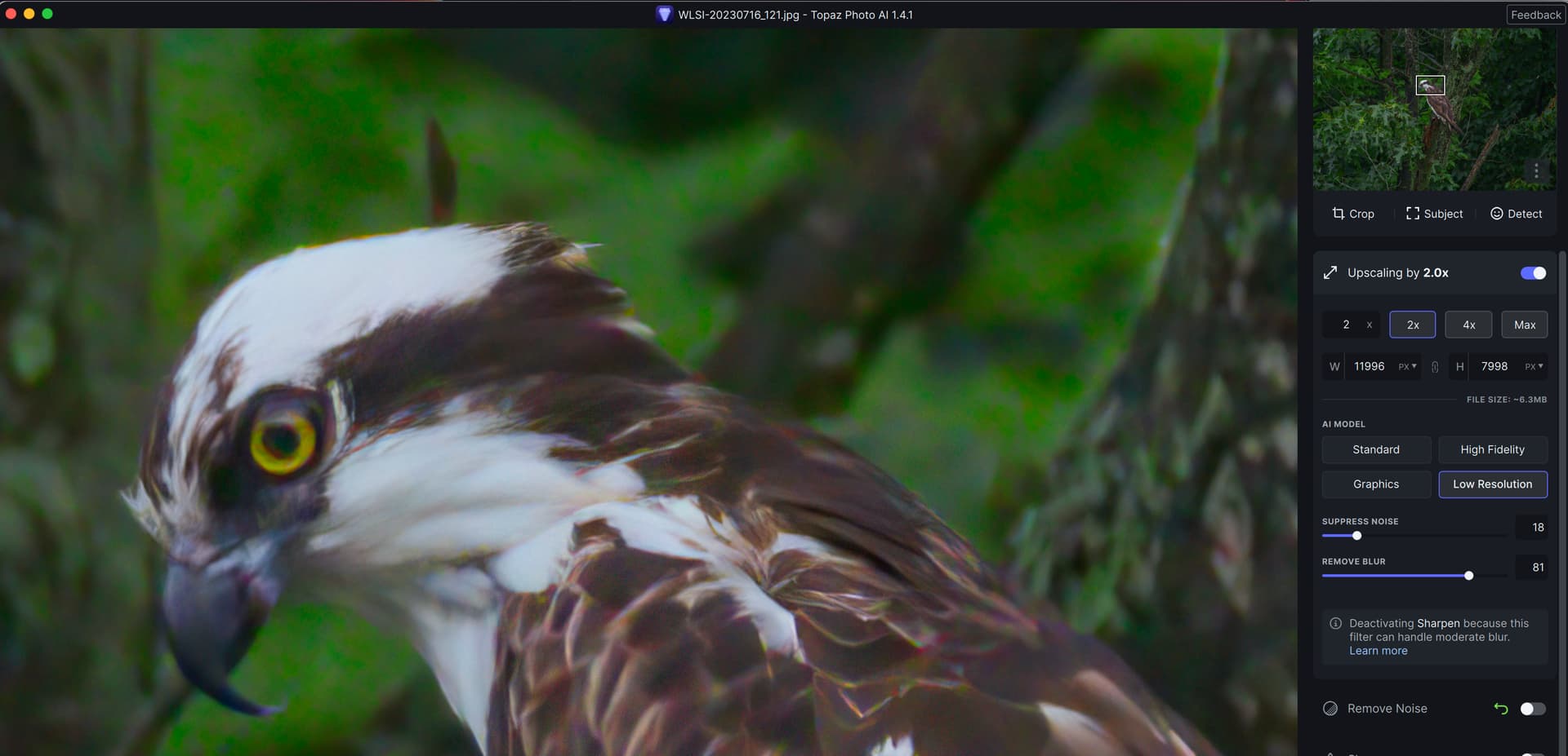

Upscale/Standard - tiling artifacts:
I don’t see these artifacts in other upscaling modes:
However, if I turn on “Remove Noise/Normal” these tiling artifacts for Upscale/Standard disappear

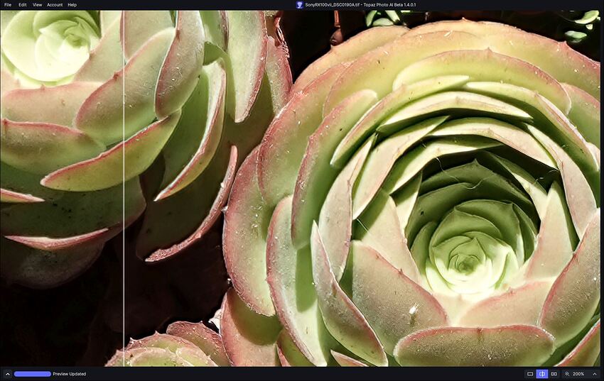

Same plant image as above but just processed with 1.4.0.1b models. Only thing undesirable in that rel. was the funky +/- switches & hidden models list… This model processing looks better to me. I’ve reinstalled it for use as Ps plugin… but I strongly dislike working with the +/-'s in settings panel. That’s same rel. I used and liked (around Jy. 1) for all the detail work in the Breguet watch.
