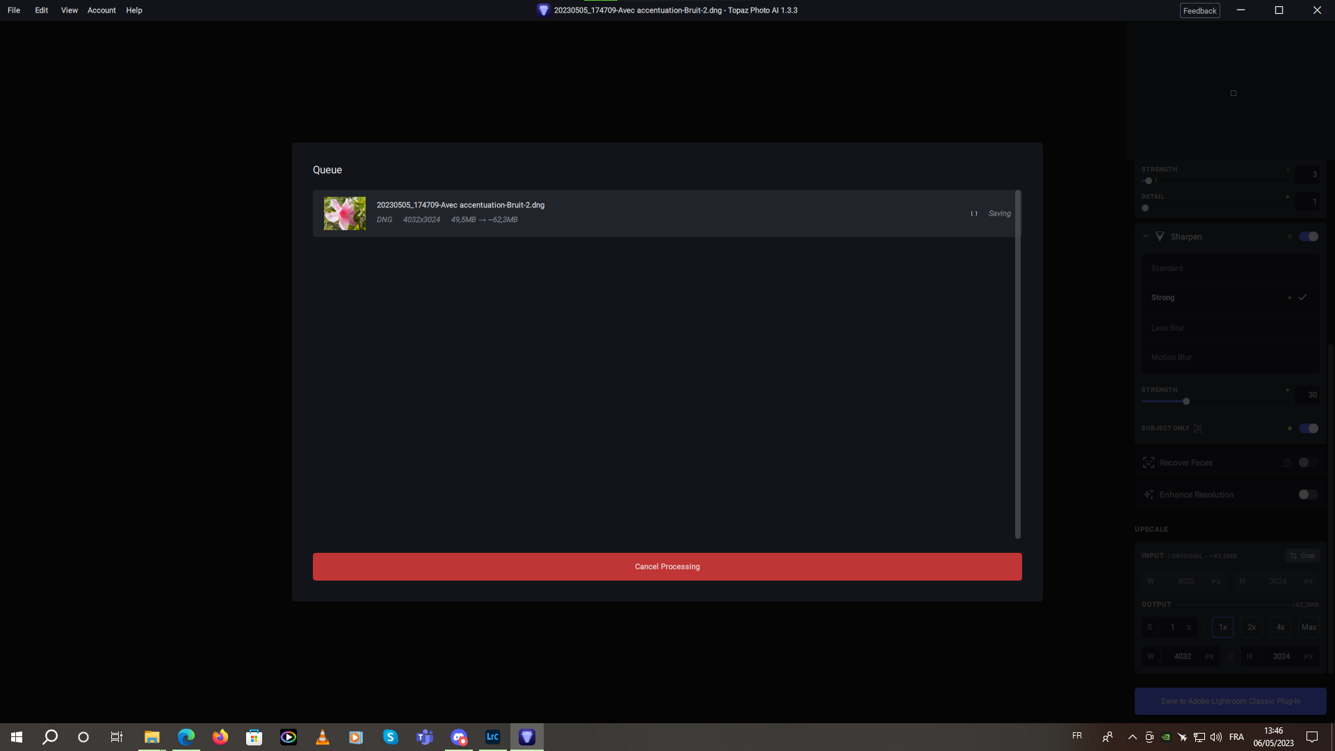

When I go through the extra module in Lightroom Classic to send the DNG directly to photo ai and after I’ve made my little adjustments, well I notice that when I save to Lightroom, it loops.
After 5 minutes it’s always like that.
It seems that the function to switch from Lightroom to Photo Ai from the extra module is broken at registration. Or it is to save DNG files that is broken.
luckily, by right-clicking send as TIFF file, it still works fine.

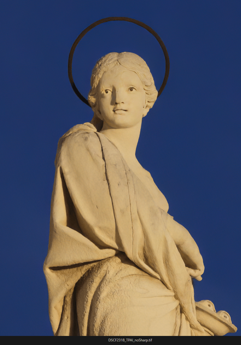

There’s still a visible pixel shift when sharpening:
SharpenPixelShift
Edit: it only applies to the ‘Standard’ model. The other sharpening models do not shift.
Well, actually, no. It doesn’t work either.
It’s normal, it’s with the sharpen strong or with motion blur. It’s to catch the blur due to the camera movement.
The above is using the normal sharpen, not strong or motion blur.
Strange because I don’t have the problem with the standard sharpen
I only have the issue with standard sharpen. The other 3 models don’t do this.
Actually that’ll be my workaround, thanks. I’ll just use the strong model on a lower setting. Seems to look better with less blooming too.

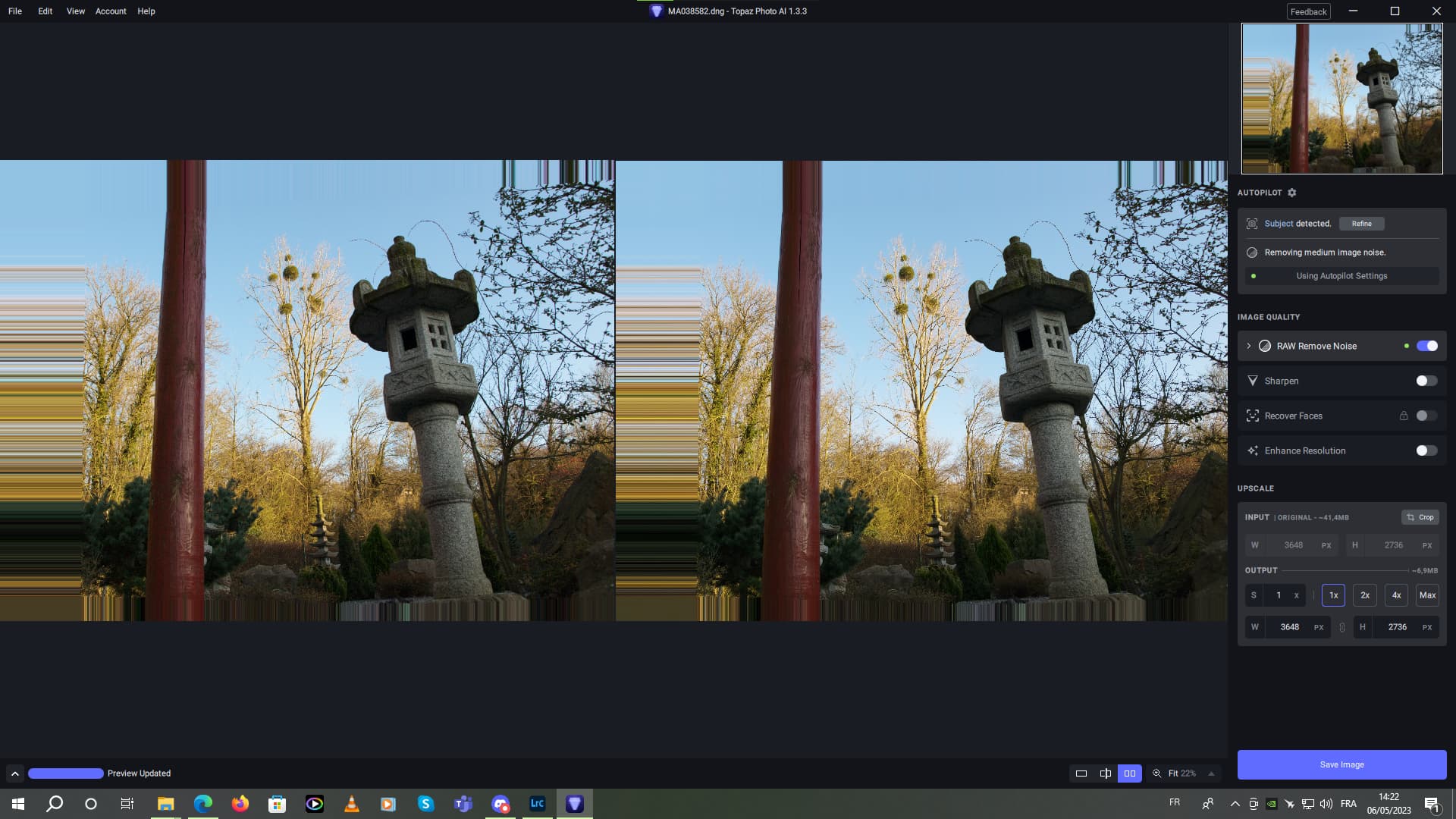

Another bug, it adds strongly stretched lines on RAW files of type ORF
Before this kind of bug was on DNG files and not on ORF files.
The good news is that the export still works on ORF files. The bad news is that it also exports with strange lines as if the edges of the image had been stretched. See image on the right
in conclusion, on Raw files, the last version brings a lot of bugs that were not present on the previous versions.

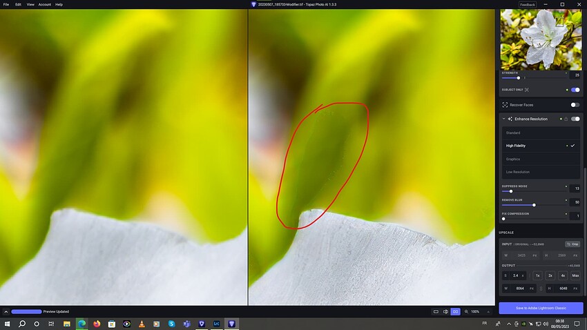

I noticed yesterday some artifact bugs with the “High Fidelity” model. As you can see on this picture.
It seems to happen if the image has already been processed with 100% denoise from another program such as the new Ai denoise from Lightroom classic.

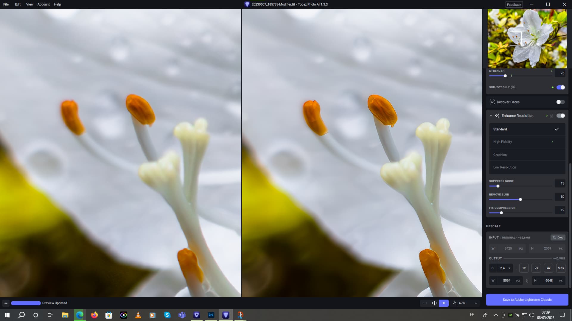

This disadvantage was not there on the 1.3.2 of Photo AI. Moreover this model was even better in the previous version. So for the images I process, the Standard model is superior in quality.
We can see with the same settings the difference between the 2 models.
Here with High Fidelity
And here with Standard
