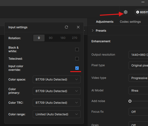

Do you know what color profile the PAL DVD was recorded in? It is possible it was a different color profile and the models are seeing it differently when processing. Is the change in exposure happening in the preview and the export, or just in the preview in the app?
In the top right corner, there is the input settings option and you can override the color profile there if you want to see if that helps.

Yes I can recommend, solved my color shifts, that sometimes happens, anyway it’s good because video is then really BT.709 and if Topaz doesn’t automatically detect the color space, you can enable input override in Topaz and set everything to BT.709, because it is.

Huzzah! Success! I tried the suggestions in order of posting and I didn’t have any success with selecting the Override and changing the color space to BT709 but the conversion script in ffmpeg solved the problem. The upscale is still slightly brighter in very dark areas (maybe on the order of 5% to 10%) but it’s quite subtle and is only noticeable with a direct comparison.
