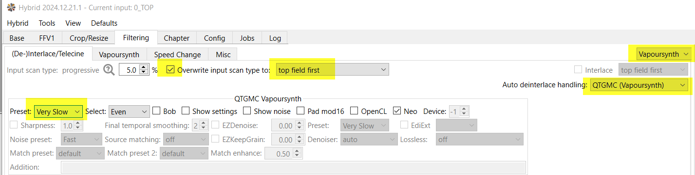

Hello and welcome. I recommend checking first it’s interlaced or not, Hi8/DV8 I think it is, but check this optically. Download and install Virtualdub2 if not already done. Drag the video into VDub and add filter “deinterlace”, check if it is “keep top field” or “bottom field” try both, in this sample it was “top field”
Close VDub, download and install Hybrid
Drag your video into source field, select lossless codec “ffv1”, select container “mkv”, click on destination and select output path and enter name (do not enter file extension, Hybrid does it)
open register “Filtering” and Deinterlace Tab, choose Vaporsynth QTGMC, select checkbox “overwrite input scan”, choose “topfield first” or “bottom field”, the one you find out in the prevous Virtualdub step. Select preset “very slow”, it’s very import deinterlacing happens slowly which gives the amazing results.
Go to the base Tab and start the job (when it does not start click two times on the icon or check register “jobs”)
Hybrid3

None of them, use VDub just for visual check if it’s top field or bottom field first. Use Hybrid QTGMC deinterlace at preset “very slow” (or placebo) as described above, it’s world best deinterlacer :slightly_smiling_face:
