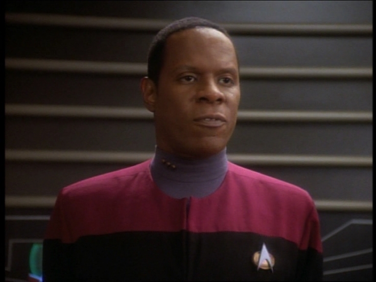

I’ve used your process (only with Gaia added to Step1 as a second enhancement), and I’m quite impressed so far. :+1: :slightly_smiling_face:
DS9.S01E12.PAL.DVD.mkv_snapshot_08.21.821
Did you add artificial noise?
I’m noticing a significant color-shift, as if the wrong color matrix was being used (Rec601 vs 709 mixup). Other than that, yeah this software can do wonders sometimes :slight_smile:

I usually add grain to the picture (I’m not sure I’ve used noise in this example, but I have toyed with that setting); the colour shift nearly always happens with many videos I upscale.
I wish this wouldn’t happen.

I’ve noticed that separate runs with different models often produce different results compared to a single run with a second enhancement added. I would have thought that the reduced FPS from adding a second enhancement was the result of TVAI doing multiple passes on each frame, but apparently that’s not what’s happening.
Yeah, I’ve noticed that as well. I can’t really form a hypothesis why TVAI fails so consistently at interpreting colors correctly when source clip dimensions hover around the common SD resolutions. It used to be in old FFMPEG versions (and most players) years ago that it would completely ignore any color meta-data in the clip and instead decide on its own what input color space to use using this very naive and poor function: “if rez < 720p set input color to REC.601, else 709”.
This was fixed years ago though in ffmpeg, and now it will use whatever color metadata exists in the source clip, and only fall back to the old behavior if the clip doesn’t have any meta-data. I always convert to REC709 any non-HDR clip first before starting any video-processing work. Using vanilla ffmpeg this way never has any color related problem as a consequence. However TVAI seems to not always respect the color metadata for some strange reason. The only hypotheses I have is that they’re either using a very old version of ffmpeg (discounted since the version information indicates they’re using pretty much bleeding-edge versions from the ffmpeg source trunk) or they’re not using ffmpeg/av*-libs to load the clip, but does the loading on their own. Only the latter would seem plausible in this case as an explanation to the observation.
Anyway, one workaround I’ve found is to take the TVAI output and do another encode pass with ffmpeg where I force the input color space to e.g. REC601 and output to 709 (again!), or the inverse (since sometimes it seems they’re adding metadata claiming the TVAI output clip is 709 when in fact they’ve used the 601 coefficients, completely messing everything up for further processing).
PS. Side-note, I’m working on a model to detect original color spaces via heuristics (image features) instead of meta-data, so I can automate the correction of the TVAI output. It’s a real PITA and time sink to have to double check every single clip produced by TVAI manually :frowning:
The odd thing is they had this colour-shift-issue fixed a few version-points ago. (I complained about it often enough…)
