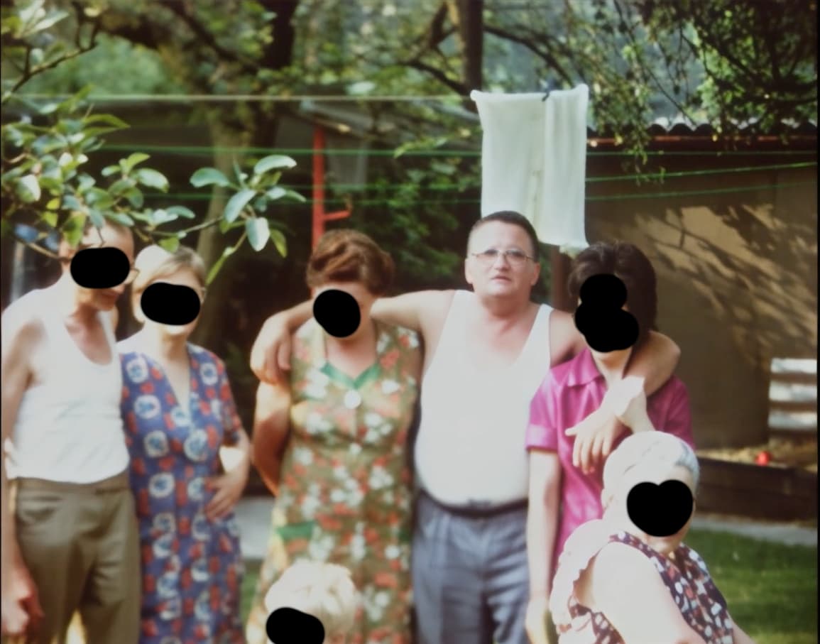

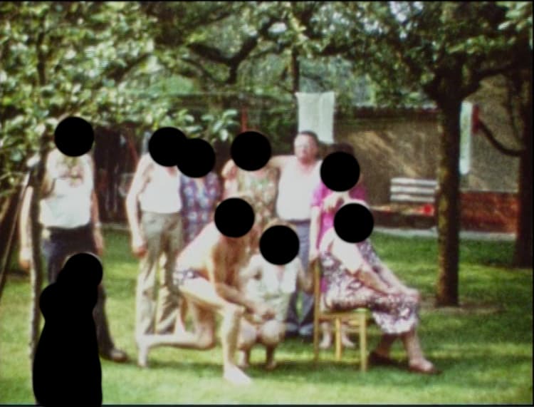

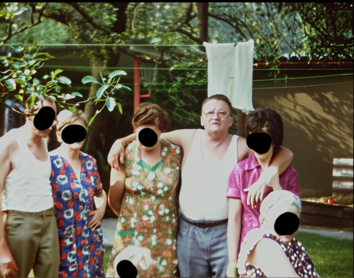

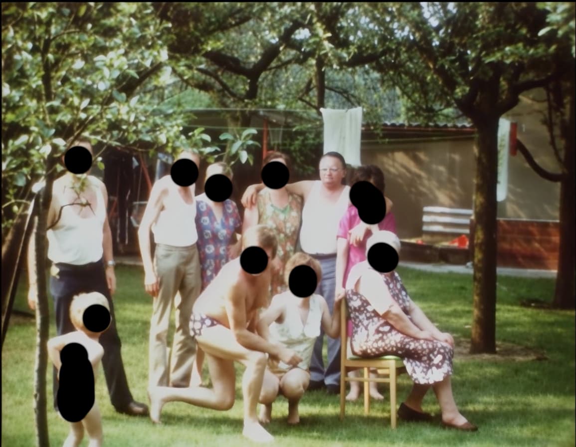

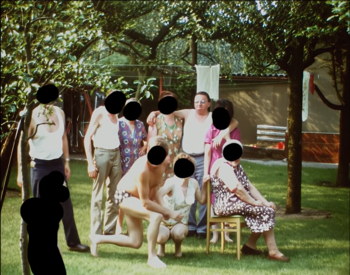

I have the impression that todays Starlight has deteriorated significantly in the cloud compared to May 2025 tests.
I uploaded a test video on 05/05/2025 and repeated this test on 09/17/2025 with the same source. I am shocked at how much the “natural” focus has shifted and how details and sharpness have deteriorated.
The quality of the versions from 09/17 is similar to the local SLM version.
Original source: Super 8 video, digitized in 576p
The new tests were conducted in VAI 7.2.0.2 and VAI 7.2.0.3.b Studio. There is no difference between them.
The May version is a stunning result compared to the original.
Comparisons:
  • Starlight (mini) Cloud 05/05/2025 (tele + wide) 1348 x 1080
  • Starlight (mini) Cloud 09/17/2025 (tele + wide) 1440 x 1152
Can anyone confirm this problem?
