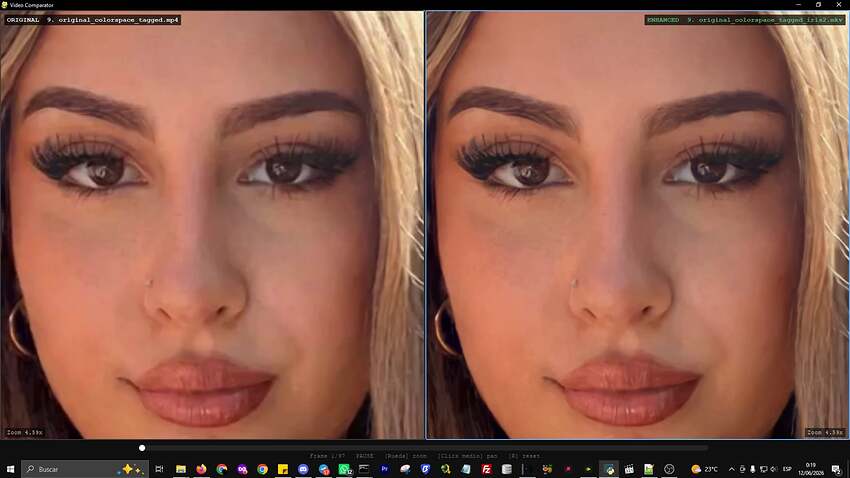

The colors change noticeably with any Topaz Video upscalers
video: https://www.reddit.com/r/topaz/comments/1u3m18r/the_colors_change_noticeably_with_any_topaz_video/
left: input, right: output
I’ve tried all the models, all the settings, several codecs, and I even forced the color space to not be set to Automatic, using BT709 and Limited.
Nothing works. I recorded the video in OBS; I hope the color error is noticeable. I managed to create a Python script to modify the color and bring it closer to the original video input, but there must be a way to preserve the colors as much as possible.
I’ve also noticed that even in the pre-render within the tool, the color changes are already noticeable.
I’ve read old posts about this, and it seems to be a long-standing problem in Topaz. I hope someone can help me.
