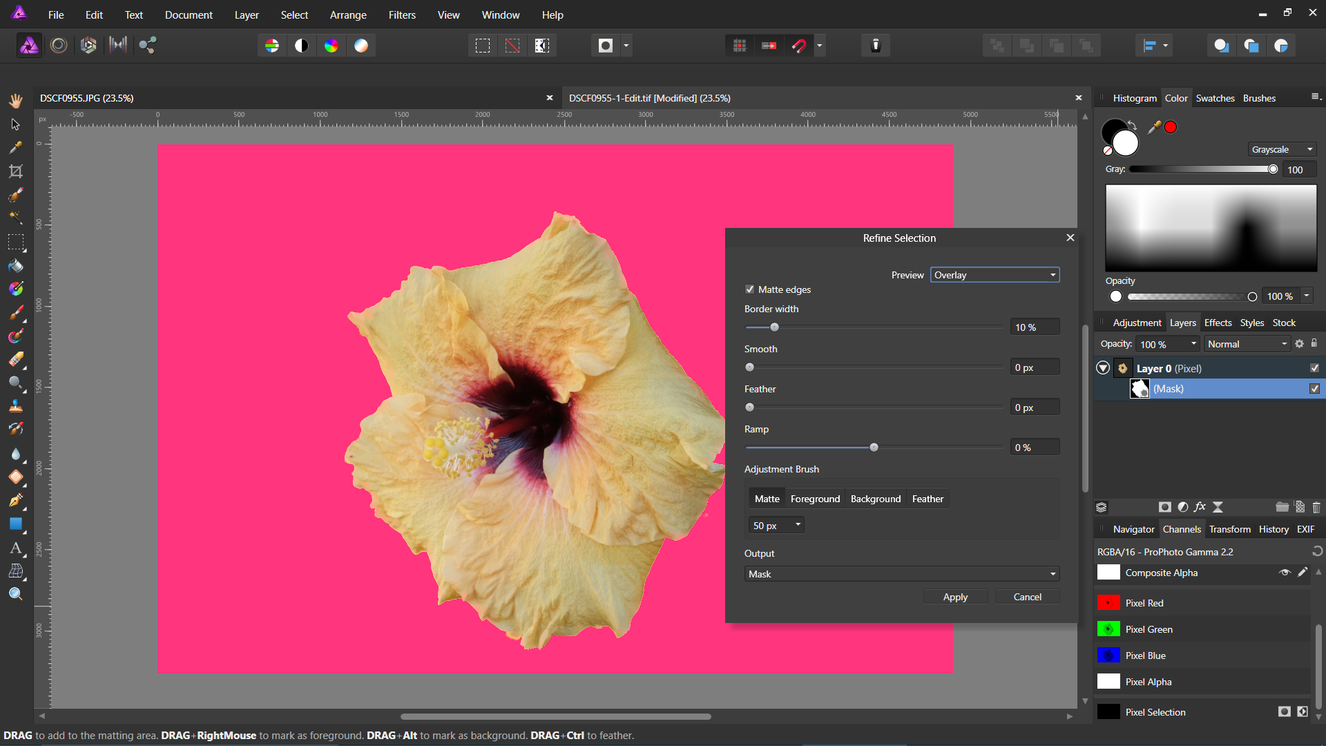

Just FYI if you mask in ReMask and save as a TIFF with Alpha and then bring it into AP and then refine the mask it makes it perfect …
But, that doesn’t make Studio work but it may be a way around when the 1.2 version is ready where you save the output as TIFF and then import into AP.
