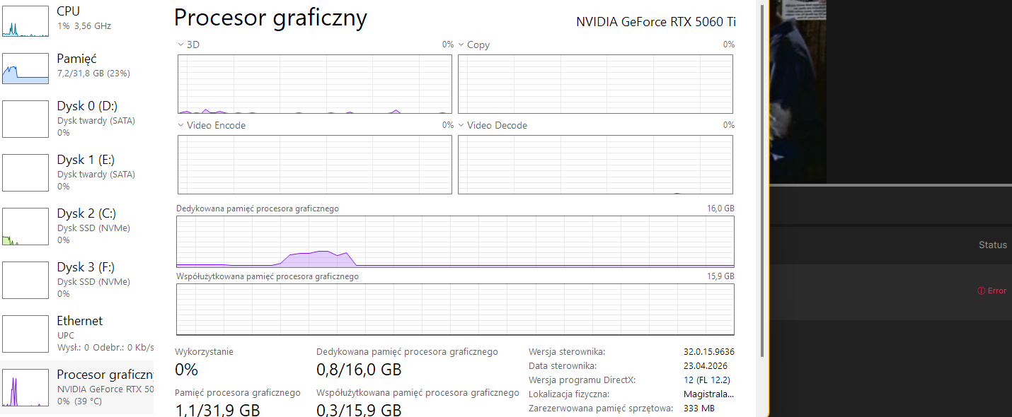

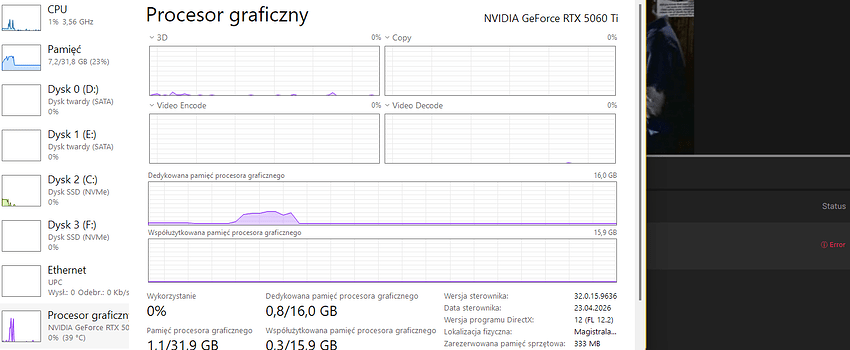

I reinstalled Studio Driver ver. 596.36 Apr 28, 2026 and set all settings like you want.
As before, two of the five Starlight models cause an error. Mini, Sharp and HQ work well.
