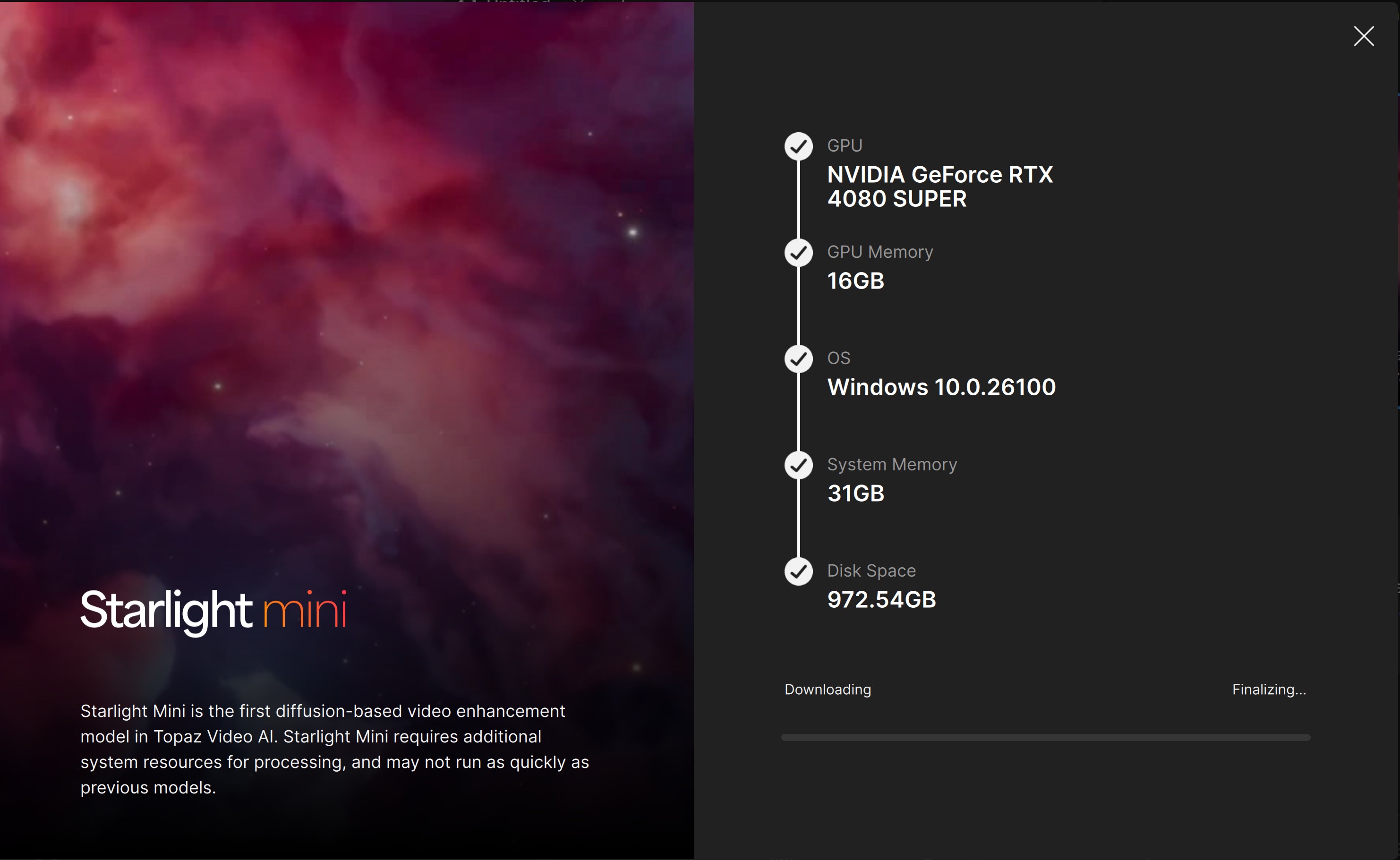

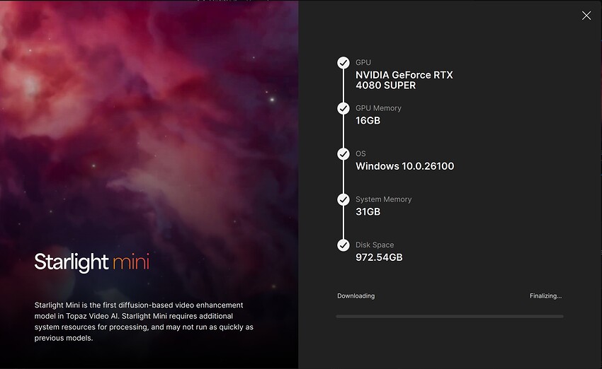

Starlight Mini funktioniert nicht
  1. Download Starlight Minizeigt kein Ergebnis. Nach Schließen des Pogramms erfolgt aber kein weiterer Hinweis zum Laden. Bei den Enhancement kann man jetzt Starlight mini auswählen. Aber bricht nach wenigen Sekunden mit “error”-Meldung ab.
  2. Your system profile: Windows 11. Nvidea 4080 Super
    logsForSupport.zip (29.8 KB)

I just re-downloaded Video AI, it has worked very well in the past, no issues. I just can’t get Starlight Mini to download. It checked out my system :
HP Omen 35L
Intel Core Ultra 7 processors
NVidia GeForce RTX 4080 Super
close to a terra memory free
no issues, then… nothing.
  1. Your system profile
  2. Your log files (Help > Logging > Get Logs for Support)
  3. Any screenshots as necessary
Did you try closing and restarting TVAI?
Some people reported that SL mini download only succeeded after a few retries…

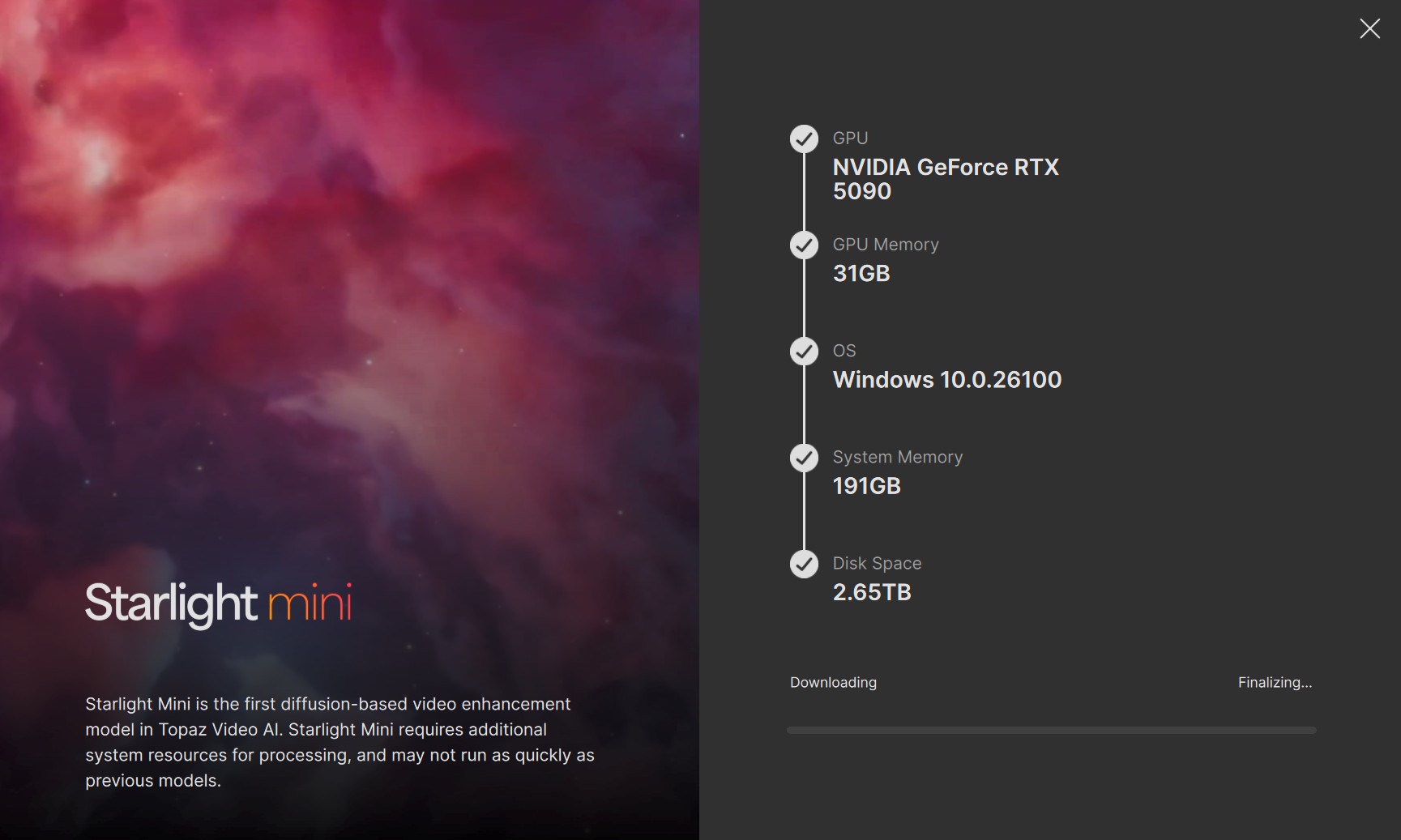

Same issue with me. I’m a new user of Video AI since yesterday, and cannot download Starlight mini
I have posted before that I was unable to get the download working and then finally it did. However, now Topaz wants to download Starlight mini again and again and it is not downloading. So it seems to be pot luck. I have sent an email to support.
