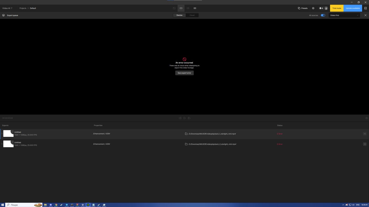

I downloaded different versions of this program, everywhere I downloaded and installed Starlight mini, it always says – ERROR
no matter how much VRAM I allocated
or the video resolution.

This is a known issue that the team is looking into at this time.
It is showing as a file path issue and not a memory error issue. As the team gets more of an understanding of the situation, I will update you as I can.
barbarikiooo1 It’s just a straw, but in rare cases it happened before the wrong GPU was taken. Deactivate the AMD GPU in the BIOS.
I went into the device manager and disabled the AMD graphics card from the processor, and I managed to get the video to start exporting
