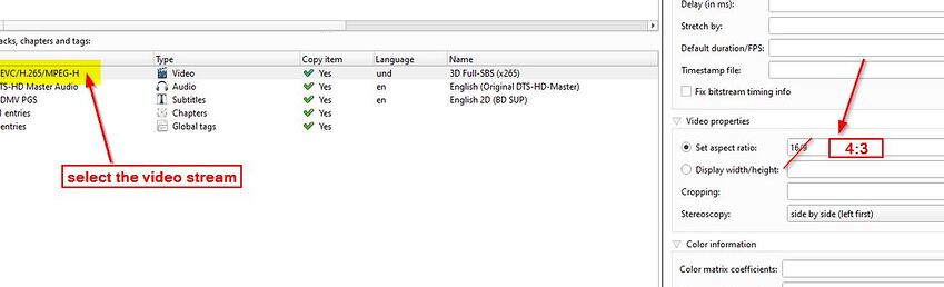

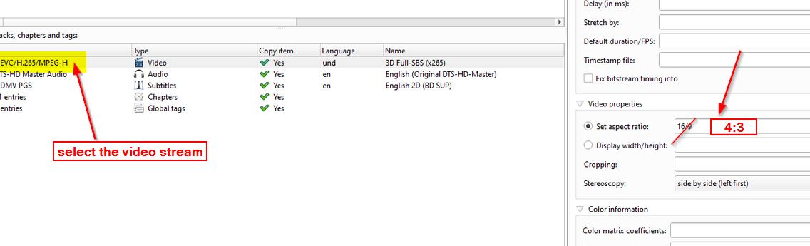

You can remux source with MKVToolnix, select video stream into the program and enter aspect ratio you want (here type in 4:3)
Then Topaz checks real pixel amount does not match set 4:3 and then Topaz gives you the “square pixels” option, select it and result is 1280x960
