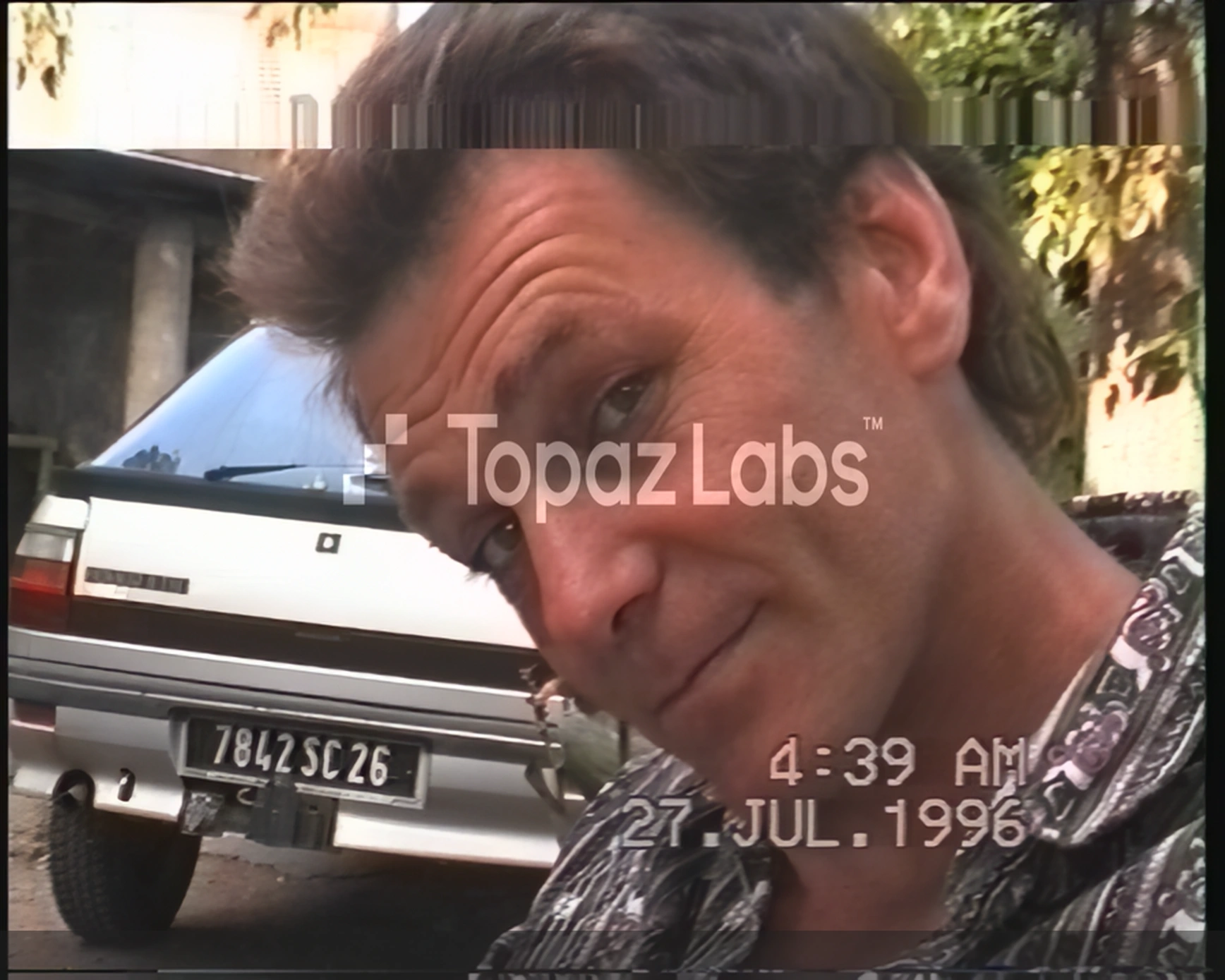

here i tried qtgmc with draft + maa2 antialiasing without resolution change (720 x 576) followed by proteus hd (1280 x 720) with default options and detail recovery at 0.

I also tried deinterlacing without doubling the images, at 25 fps then using aion, appolo, chronos but there are always artifacts, and necessarily loss of details… and I would really like to keep the 50 fps for old family videos to have all the original details. in souvenir videos, I think that fluidity is important
I just tried all the interpolation modes on a 50 fps video deinterlaced at 50 fps > 120 fps. There are still more artifacts, I tried deinterlacing with qtgmc in draft at 25 fps, and proteus at 25 fps in hd works well, but there is loss of detail in the movements and there are a little less artifacts than if it was deinterlaced at 50 fps. So if we double at 50 fps with appolo for example, the video is quite clean but there is still this loss of detail in the movements
there are also fewer artifacts by doing a first pass with proteus in hd then importing and doing a pass with chronos by doubling rather than combining proteus and chronos, in my case chronos is better than appolo and aion
