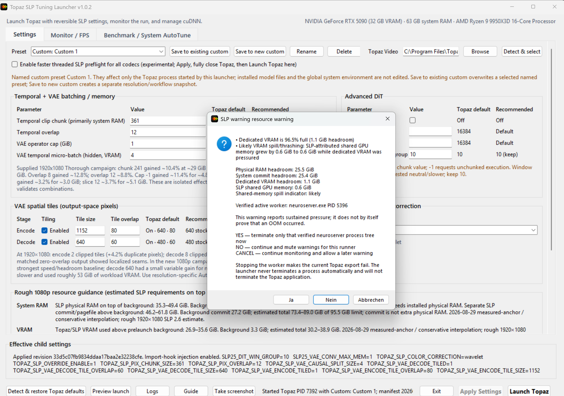

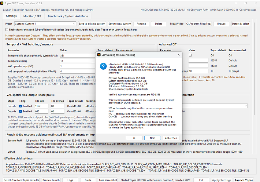

That popup indicates that your GPU is running out of VRAM. What output resolution are you using? A chunk size of 361 combined with an encode tile size of 1152 is quite aggressive for a 32 GB card.
Please also take a screenshot of the Monitor / FPS tab so we can compare how much VRAM SLP is using with how much is being consumed by background applications. I recommend running AutoTune to determine the best stable settings for your system.
For example, if you already know your system can handle chunk size 241 but not 361, you can add custom AutoTune rows to test intermediate values such as 261, 271, 311, and so on. The final tuning algorithm can only evaluate settings that were actually tested and completed successfully.
