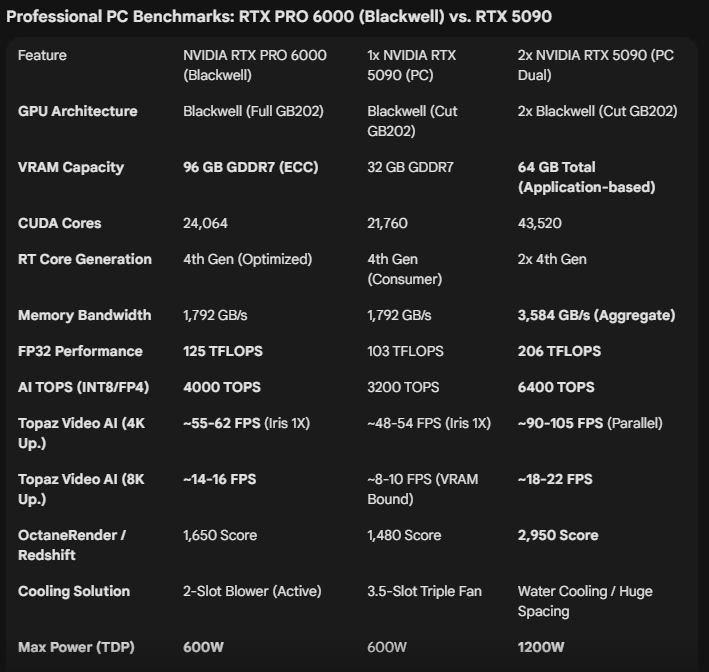

Fully agree with @Gemini who pointed very well all things :slight_smile:
@Mayday Would you share your RTX 6000 ? We will get its true potential :smiley: (kiding)
