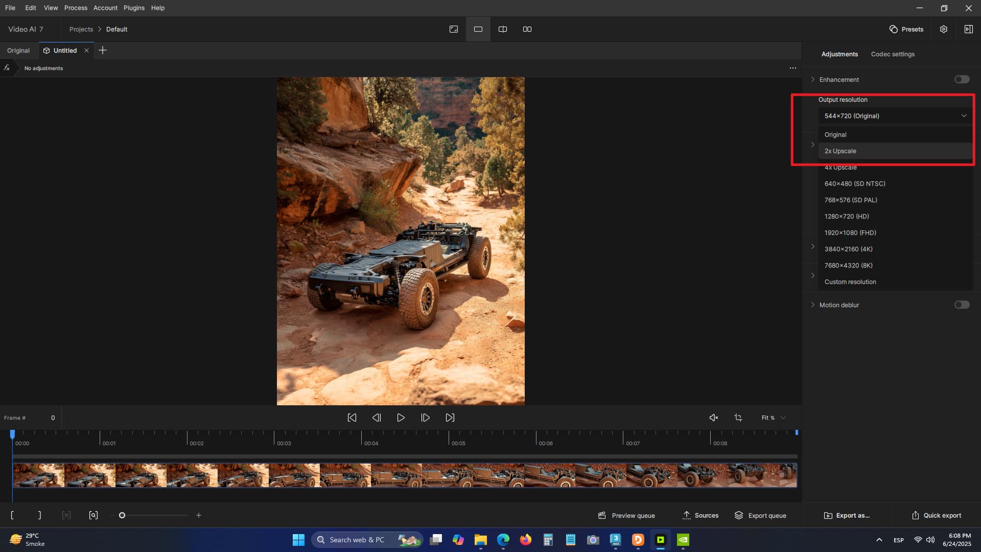

Hi,

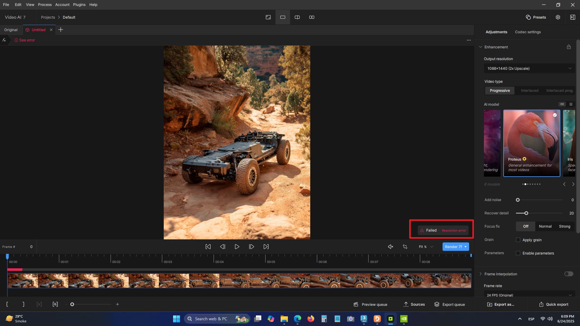

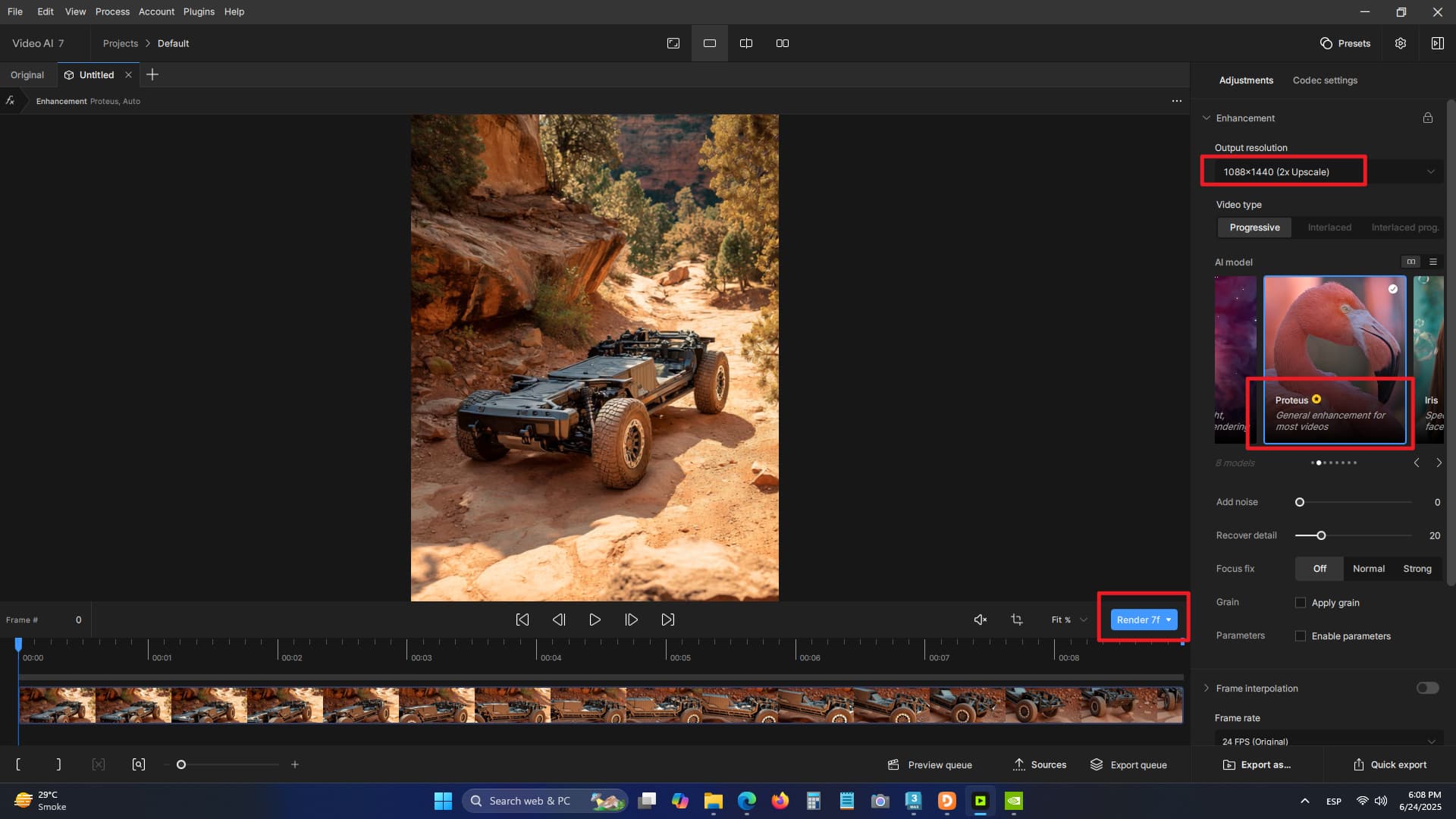

I’m trying to upscale an AI generated .mp4 video (544 x 720 pixels) to 2x upscale (selected codec H265 just in case) when trying to render sample frames (7 frames) I shows: Resolution Error.
This happens with any video and any upscale sizing and with any model.
My system is windows 11 (24H2) Ryzen 9 5900X , 63 GB ram, Geforce RTX 3070 (driver version 560.94)
