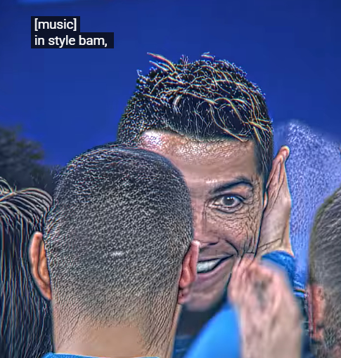

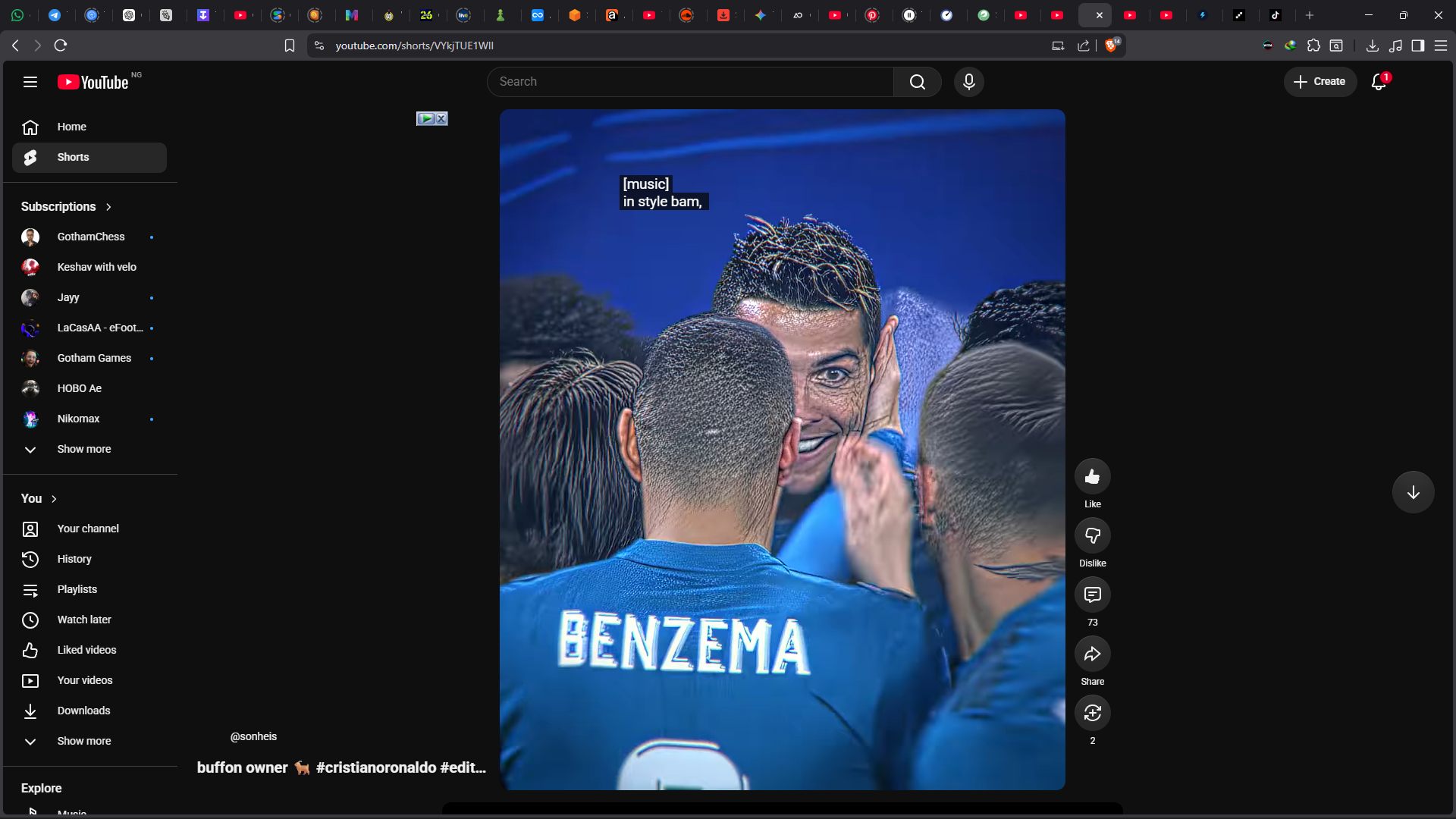

Can Someone Help, I dont know the model to get these kind of quality and the settings, your answers would be much appreciated as im trying to improve my quality
Looks like possibly a multi-pass process as the edge details are cranked up and that is not a one model option. Possibly Proteus or Rhea with custom settings pushed hard. Hard to tell exactly though.

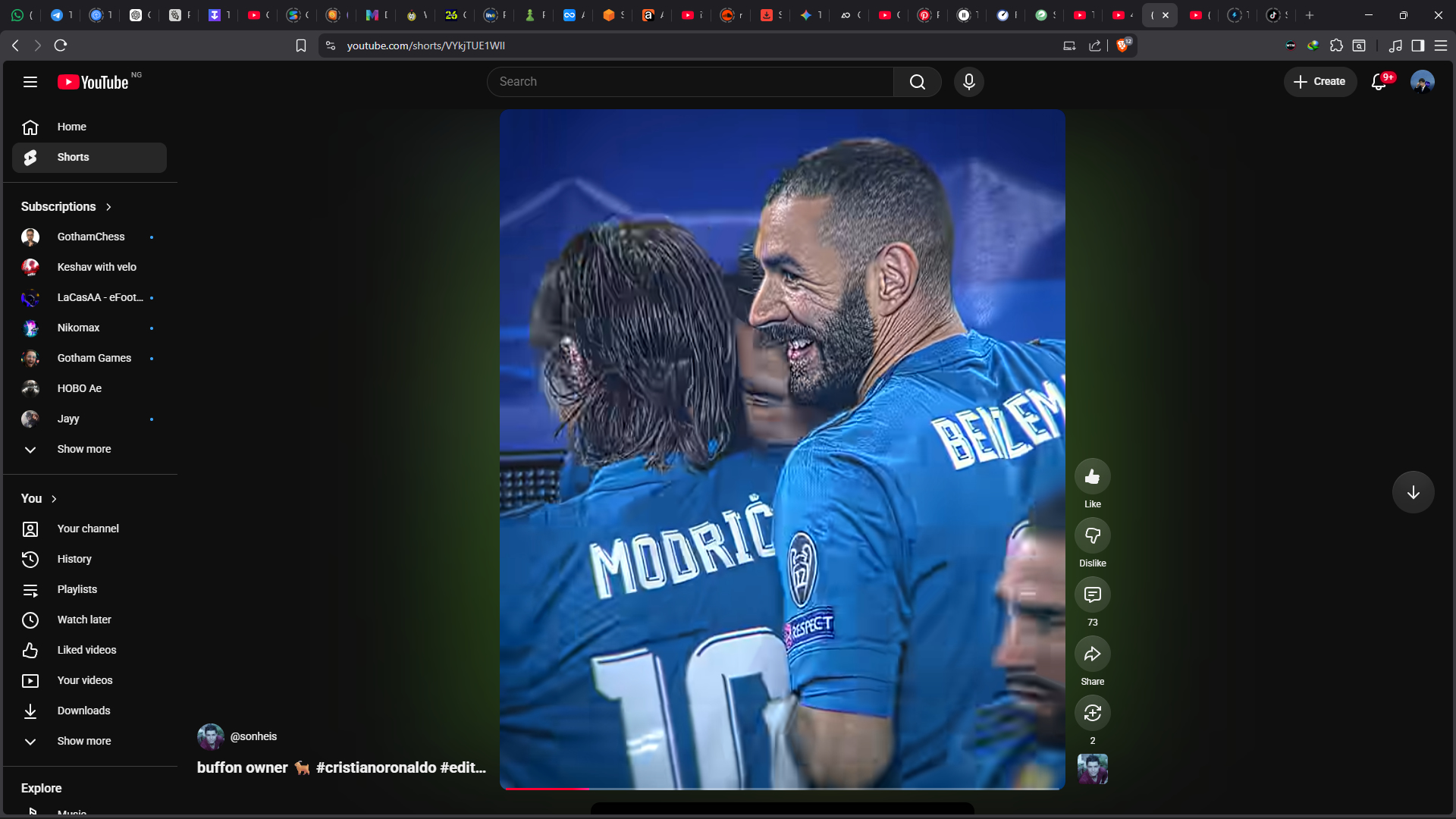

this is another angle, multi-pass? yh noticed the edges and all the criss cross edges, where can i get the rhea model? ive tried using proteus but didnt similar quality, i tried iris and i got a little bit of criss cross, but they were so tiny, maybe if i multi pass it?

hey, i watched some videos on rhea model, i dont think its the same as the one in the pic i posted, im trying to get those sharp dark lines that cause the faces and edges to be bold and clean, closest ive gotten is iris, and by passing the same video through iris upto 4 times, but i dont get any details on the field compared to the pic, in the pic, the field also has those criss cross lines
Then this could be a situation where a first pass with a Starlight model and then a second pass with Proteus is going to be the situation. Might need to look at a subscription to the Astra tool since your system specs you said were low before. This would run via the web browser instead of locally for processing.

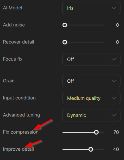

You get simillar using Iris MQ dynamic mode, set high Value of “fix compresion”, then use “Improve Detail” about the half or more of “fix compression”, for example start with 70 / 40 and play around with this two values.
where can i get iris MQ dynamic mode, tnx to y’all for ur responses, means alot, what version can i access the dynamic mode, sorry?
every version since Iris MQ was released :slightly_smiling_face:
tnx g, what topaz version is this? im using 3.3.10 though, i haven seen this layout before, fix and 70 and improve on 40, no other setting, what about recover detail, dehalo and the rest, nothing?
Screenshot is from Topaz Video (Studio) V1.61
Iris MQ was released in TVAI v3.5.2 on October 3, 2023
tnx so much, i wanted to know, is it just those 2 settings? or are there others? tysm for ur reply
