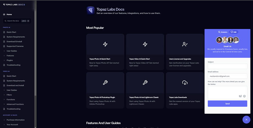

I also suggest you look at the functionality explained in the operation manual. Can be accessed through the Help, Support menu entry:
From there you can also raise a support request … note that the response takes about 8 business days through that channel. Support usually answer on this Forum (Bugs and Issues) within 2 business days.
