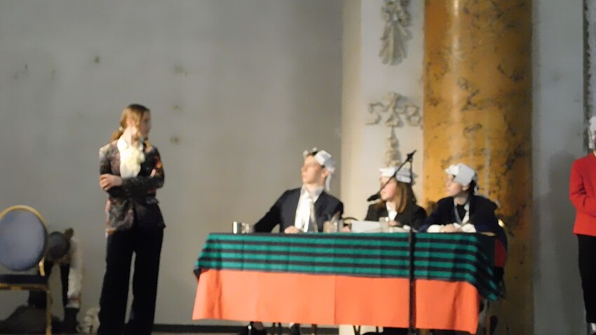

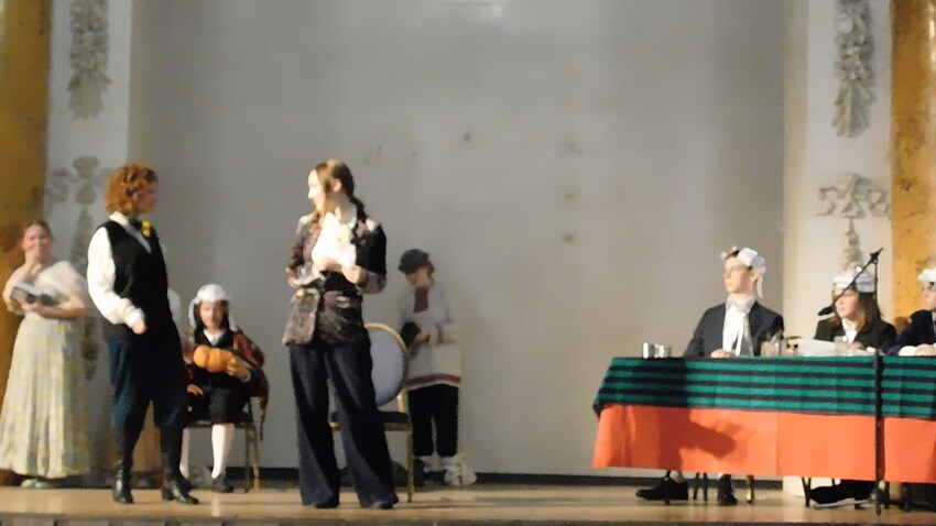

I’ve dealt with a severe lack of focus.
My workflow was:
  1. SeedVR2 (free)
  2. Starlight Precise
  3. Starlight Mini

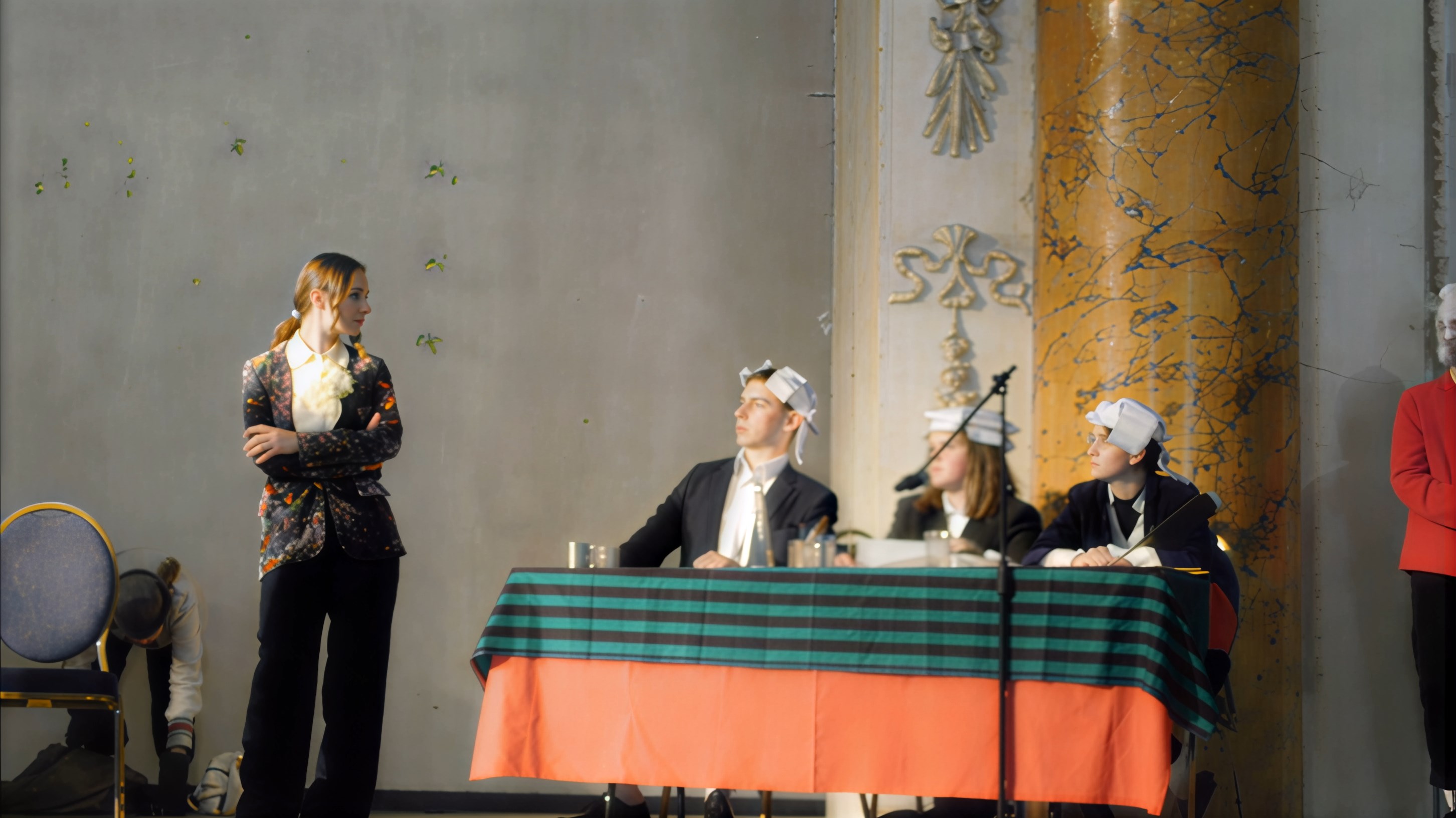

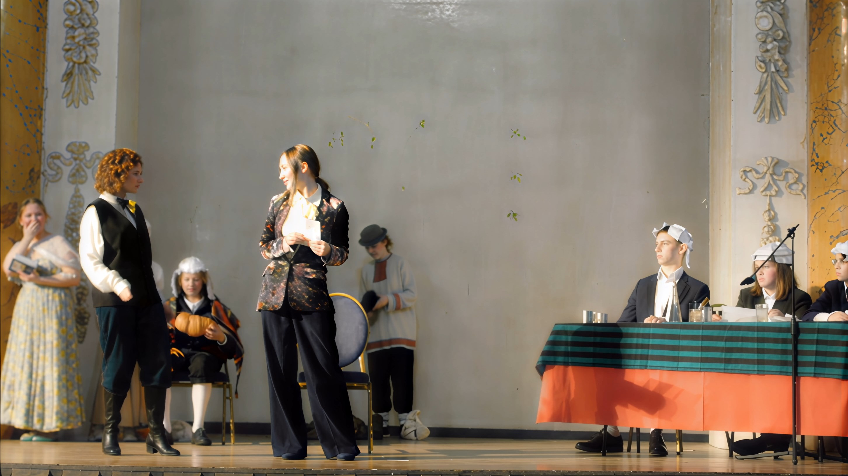

Only after three different models the result was satisfying:
BTW, straight Starlight Precise was unable to recover faces. It was able to yield good results only after SeedVR2.
Here you can see the bad file:

And the result:
https://transfer.it/t/ezv3es1TBBhK
