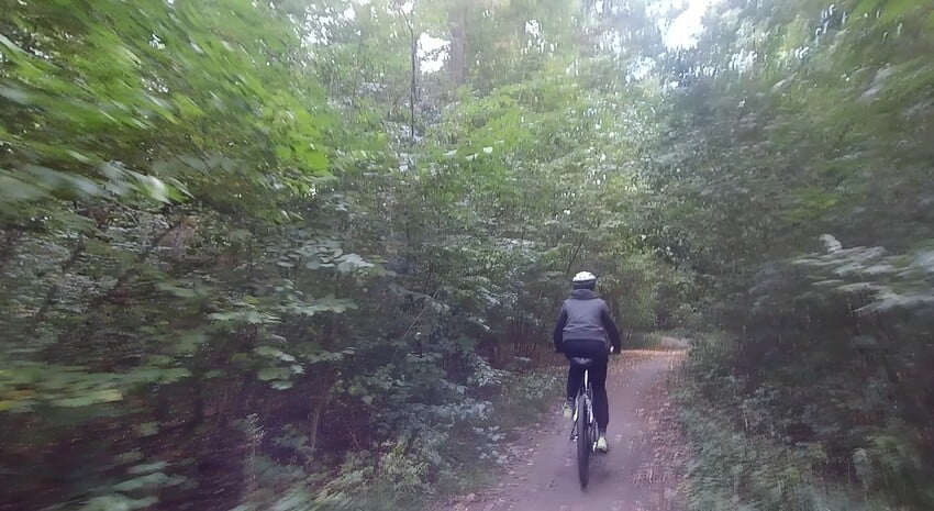

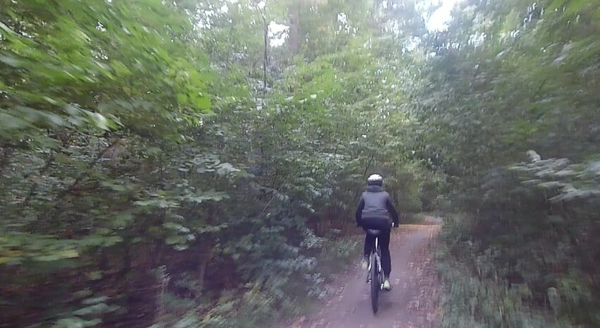

Have you encountered differences in quality when processing footage using the CPU and GPU?
Below are the screenshots—original at the top, GPU at the bottom, and CPU at the bottom. As you can see, the CPU offers MUCH better quality. Interestingly, this doesn’t happen with every frame; some are identical.
Proteus filter, Auto + sharpening:+25
I’m uploading the source file and a Windows batch file to run, which writes short out-CPU.mp4 and out-GPU.mp4 files. Just compare the first frame.
