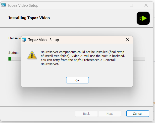

Problems With 1.4.0 Upgrade Won't Allow Neuroserver Install
So I installed the 1.4.0 release and then the enhancement videos would no longer run.
Unfortunately now, the install fails with the neuroserver files. The failure notice told me to run the Topaz Video repair, and upon doing so, I am still unable to get the neuroserver files installed. After fussing a bit with the configurations, I did a complete uninstall and then reinstall of Topaz Video. I also downloaded and installed the latest driver from Nvidia released only a couple of days ago.

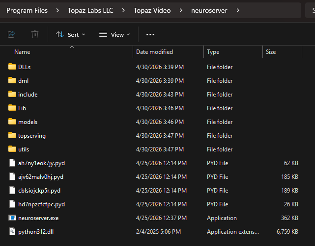

I then went to the following folder “C:\Program Files\Topaz Labs LLC\Topaz Video\” and created a new folder called “Neuroserver”.
then extracted the two downloaded files into the new folder. Note: (you have to extract the .xz twice because there is a .tar inside of that)
The final folder structure should look like what I have shown below.
After doing all of that I opened Video AI and it magically thought Neuroserver was installed .

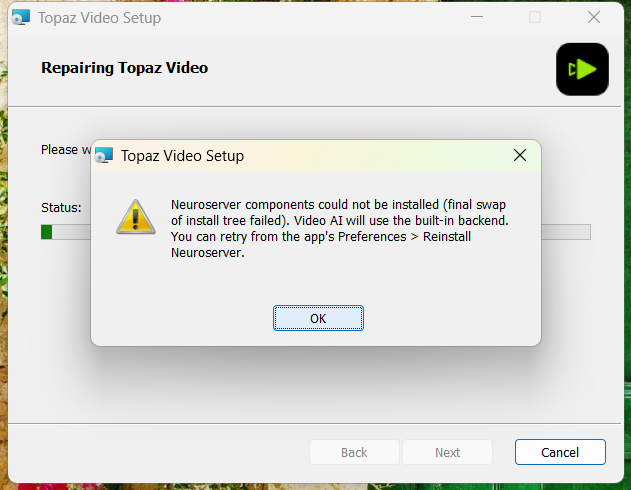

I tried to install the update 3 times, managing complete uninstalls, rebooting my computer, running the installs as administrator to eliminate this as an issue, etc. Each time, the Neuroserver installation would fail. As you can see from the pictures, I even attempted to “repair” the video app installation to no positive effect.

Neuroserver doesn’t istall even with repair function
I tried multiple times - it just does
Yes, that’s the problem I had which you can see from the two posted pictures seen above to this posting. Apparently there is a work-around involving some steps, but after struggling several hours and trying various efforts, I fully uninstalled the 1.4.0 update and reinstalled the previous 1.3.1 version until Topaz can come up with a better install version that can install cleanly like the previous versions.
