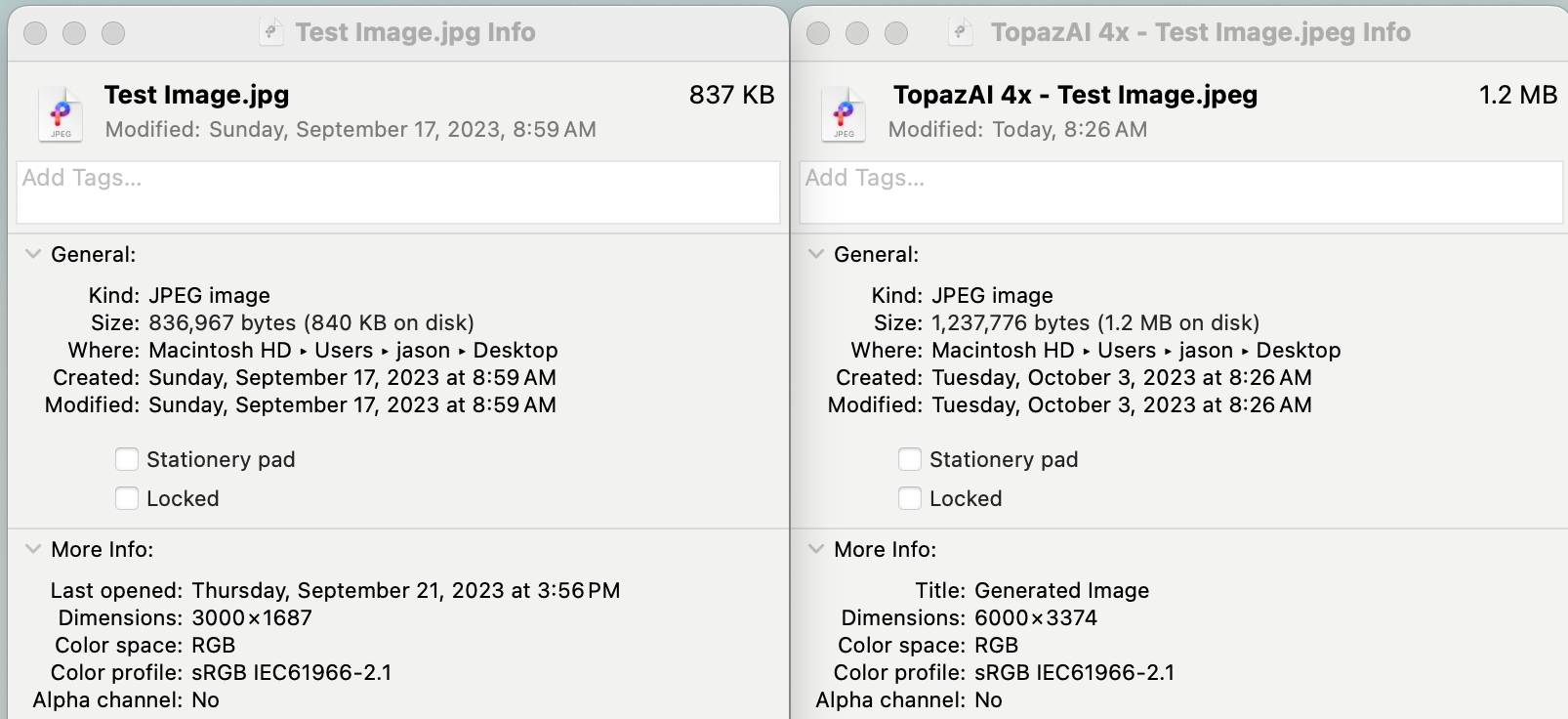

I’m on macOS. I did a test this morning to confirm the behaviour: the original image was taken on Sept 17th, and after going to through Photo AI with a 2x upscale and save, it has a time/date stamp of today, Oct 3rd.
Photo AI will show the date of export as that’s a different image file from the original.
Indeed, it does, but my request is that it should preserve the date, or at the very least give the user an option to preserve it.

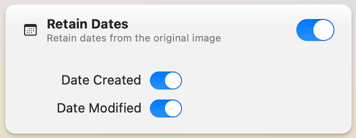

Here’s how Squash 3 presents the option to the user to protect the date of the original image. :arrow_heading_down:
SCR-20231003-mlxo
