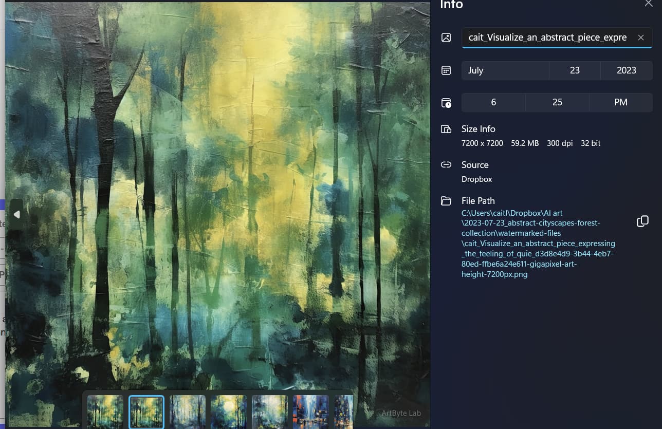

Hi, I have a file that I’m trying to Sharpen w/in Photo AI. The original file has the DPI set at 300. After running the file through Photo AI (to use the sharpen features), the DPI drops from 300 to 96.
Why is Photo AI dropping the DPI from 300 to 96? I’m not using any part of the upscale functions w/in Photo AI, so, DPI should remain at 300.
Please advise.

Can you try taking the file out of Dropbox and moving it to your Desktop for processing? I’m curious if the file location is affecting the metadata writing.

Ok, I moved the file out of DropBox, processed in Photo AI and the DPI stayed put at 300.
This wasn’t an issue earlier this week as I had one full day of Giga & Photo running seamlessly.
It’s possible that Topaz Photo AI does not have access to all the file information when processing from Dropbox.
Please let me know if you figure out exactly what is preventing the resolution from writing correctly.
