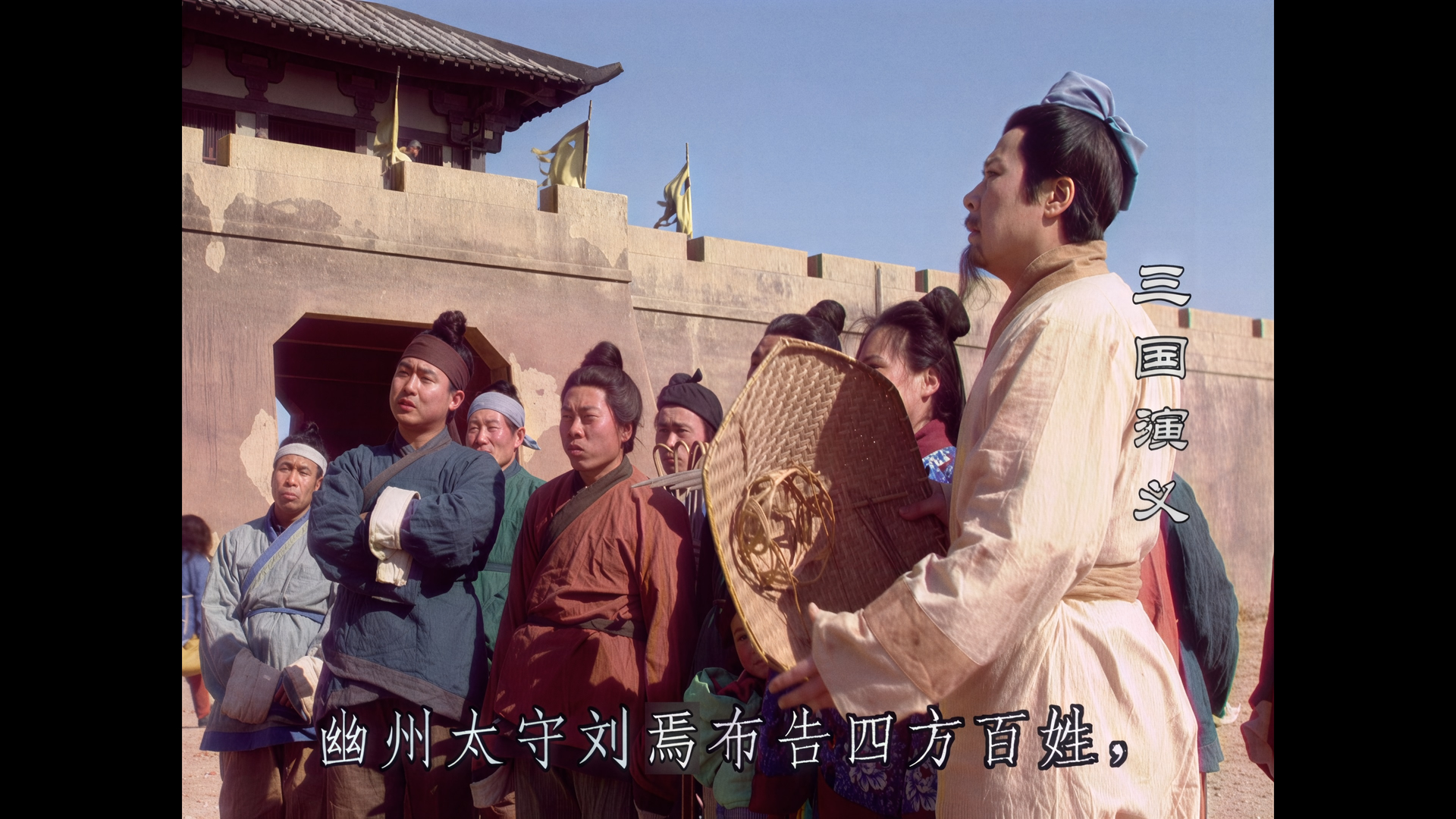

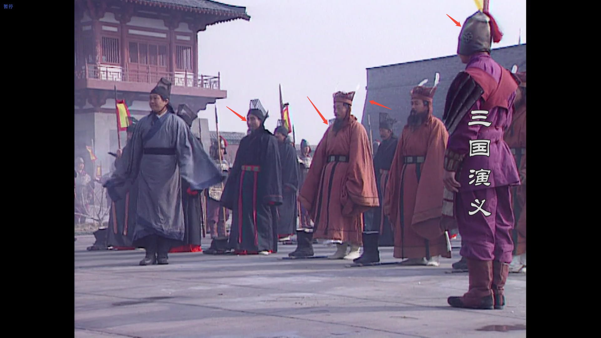

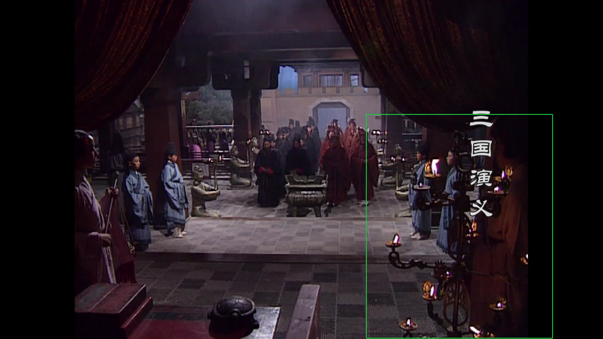

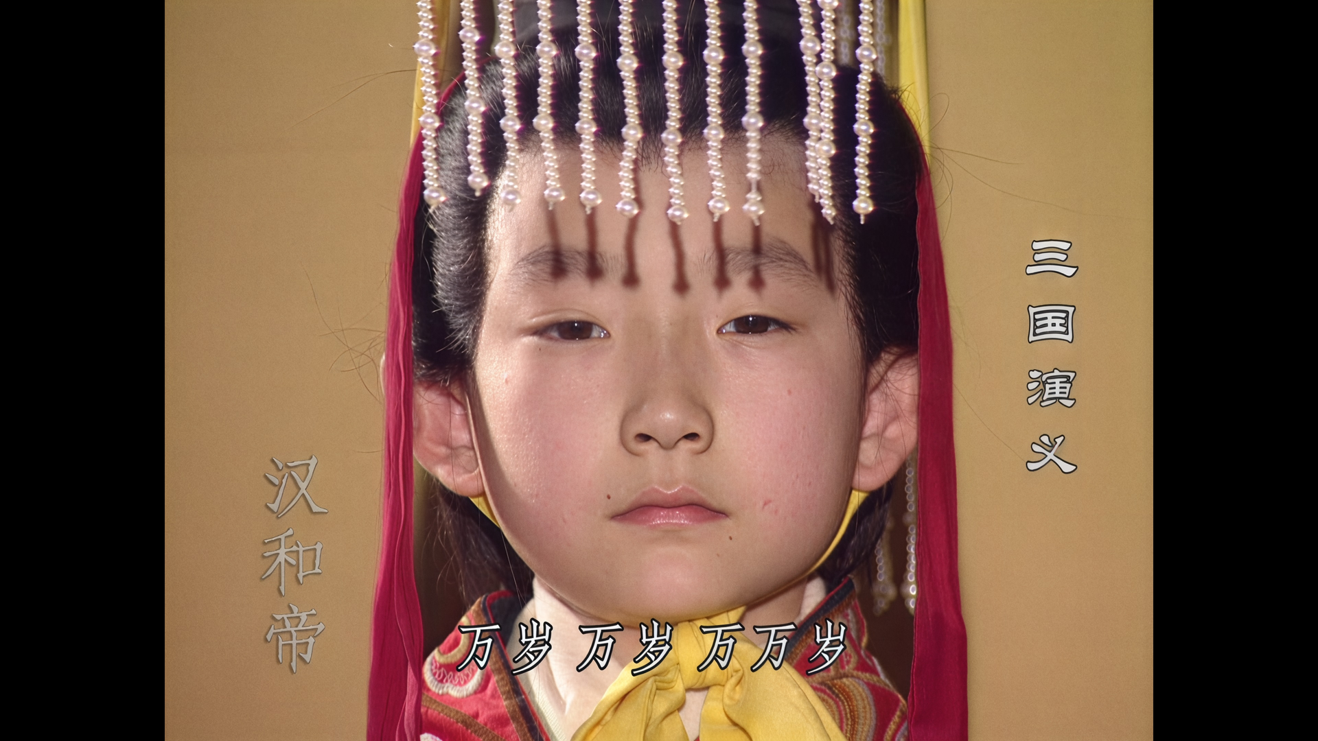

When tuning your restoration solution, besides improving general background details, facial details, and subtitle/text quality, please pay special attention to dark edges and purple fringing (as shown in the examples). I hope these artifacts can be removed more cleanly.
Here are a few screenshots with these issues highlighted. Candle flames, for instance, often show a dark line on one side and a purple fringe on the other – extremely annoying.
You are free to use different separate applications or models in combination – whatever you have access to. If the restoration quality meets my expectations, I would be happy to pay for your workflow. Starting at $500 USD. If you believe your workflow is significantly better than the baseline, the price is negotiable.
Please feel free to show your demo on the test clip. Thank you!
