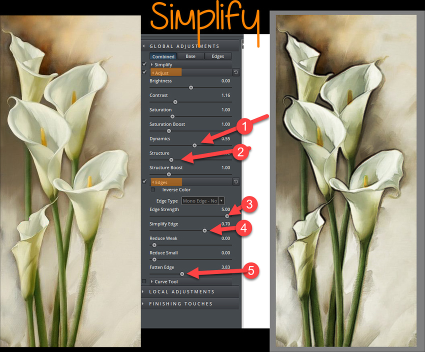

Simplify3 plugin is a place to start or EDGE filters in your PostProcessing software

Sorry I did mean to list my topaz plug in, adjust, simplify, detail,
clean, i have played arounbd in simplify with edges and can get like a
drawing tpe of edges but don’t know how to add that to my original

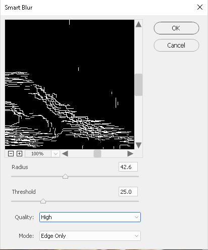

Filter > Blur > Smart Blur will get you the edges
Then CRTL-I to invert
Use one of the blending modes to add the edge to the image

Filter > Blur > Smart Blur will get you the edges – you will have to change the settings to get a thickness you like
CTRL-I to change the white on black to become black on white
