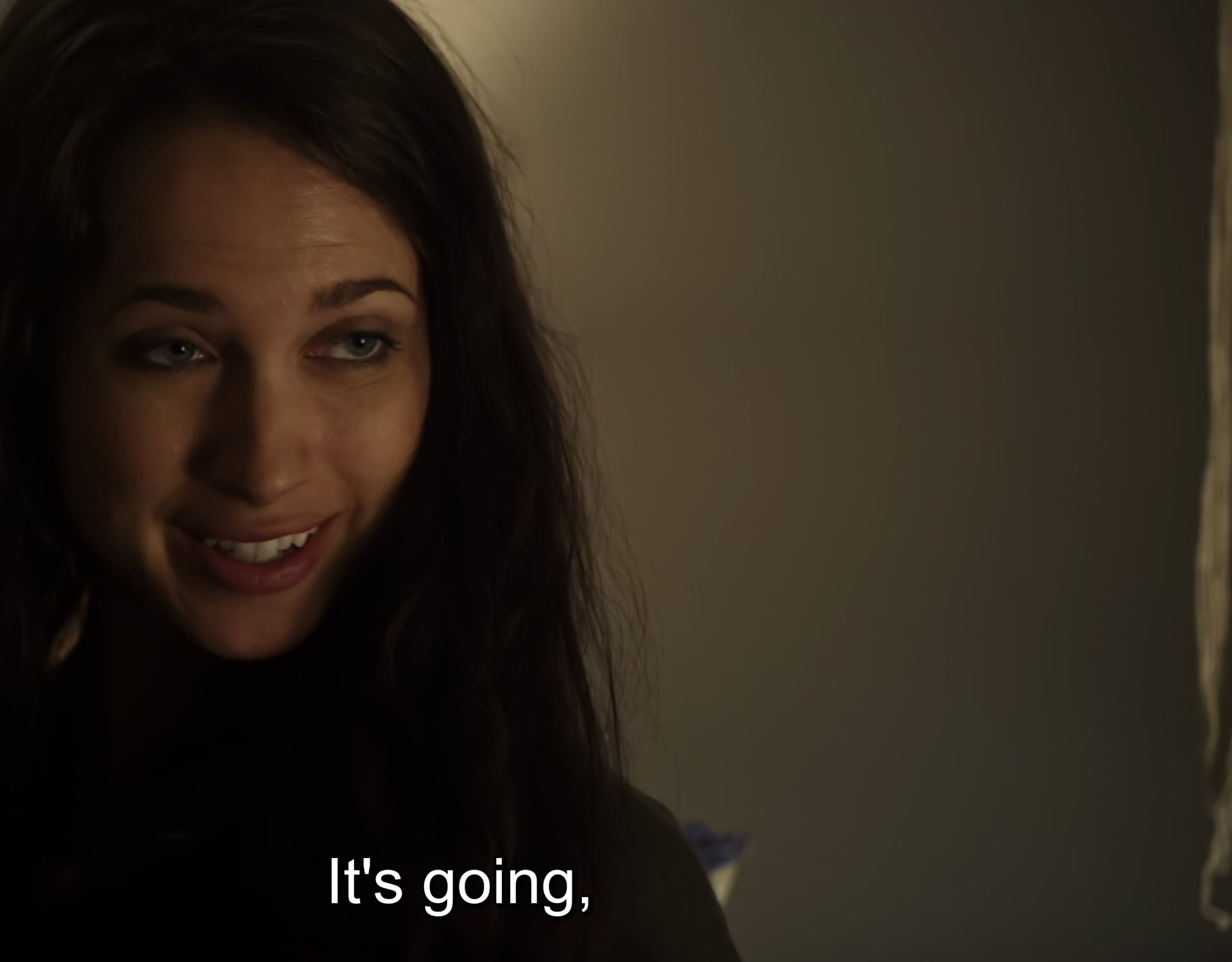

After further testing, apollo on it’s own without any other enhancement causes color banding to appear . It’s mild and it happens on movies that don’t have any grain at all and are beautifully shot in digital instead of film. Flawless movies before, can show mild color banding in some scenes after motion interpolation. Even using massive bit rates or lossless codecs can’t seem to get rid of it.
This also tends to effect films that are compressed more obviously. If I was compressing them from the beginning I’d probably leave a little more size now knowing this.
Other than that though, the results are sensational. I wish there was a sony style smooth gradation ONLY enhancement that could be used after the fact.
I found that using 265 main 8 bit instead of 265 main 10 bit on a 8 bit source reduces the color banding significantly. I always thought 10 bit would be better, but it’s not on an 8 bit source. It increases color banding in this situation.

Could you post a screenshot here where we can see that banding?
best regards
yeah 265 8 bit only reduces it slightly. Clear obvious mild banding was created as you can see below. I could do 100mb bit rate, it wouldn’t matter. The original source had zero banding, unlike this picture.
It generally effects videos less than 9mbps .264 1080p
