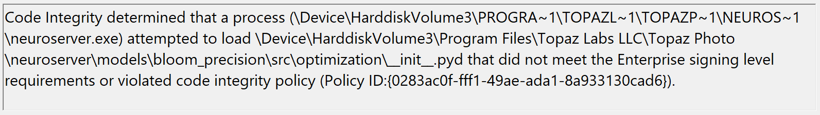

I’m still having this problem with “Windows” say that part of the neuroserver.exe is being blocked, I did the turning off of the Norton firewall and VPN, also “Allow an app through Windows Firewall” procedure, but something in windows is blocking it. I also download all the models, twice and right clicking nad running the program as administrator. What is next to try? I included our original chat below. the My computer is blocking topaz’s neuroserver.exe I allowed it to have

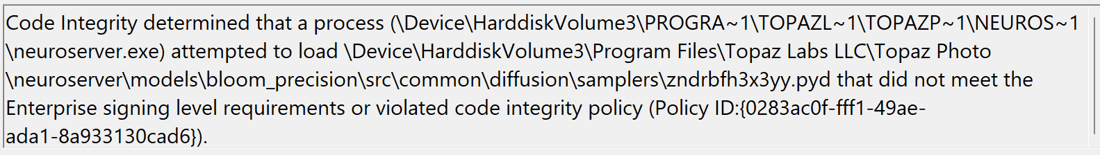

That screenshot solves the mystery entirely! This has absolutely nothing to do with your firewall, Norton, or your internet connection.
Windows 11 is using a highly aggressive native feature called Smart App Control to internally block the Topaz engine from starting.
Topaz uses specific background files (like the cuda_utils.pyd file mentioned in your error) to connect its AI models directly to your RTX 5080 graphics card. Because that specific Topaz file does not carry a standardized Microsoft digital signature, Smart App Control panicked and killed the file locally. It stopped the software dead in its tracks before it could even attempt to use the internet.
Here is exactly how to disable this block so Topaz can finally run:
How to Turn Off Smart App Control
1.Open the Security Menu:
Click your Windows Start button, type Smart App Control, and press Enter. This will instantly open the correct Windows Security settings page.
2.Disable the Feature:
You will see the Smart App Control setting is currently set to On (or Evaluation mode). Click the option to change it to Off.
**3.Accept the Prompt:**Standard Windows Defender and Norton will continue to protect you.
Windows will ask for administrator permission to make this change. Click Yes.
The Microsoft “Catch”
I need to give you full candor on a very bizarre design choice Microsoft made with this feature: Once you turn Smart App Control off, Windows 11 will not allow you to turn it back on unless you completely reinstall the entire Windows operating system. Furthermore, Microsoft does not allow you to add exclusions or bypass this feature for individual apps.
However, for someone running advanced video editing software, custom hardware, and specialized tools, Smart App Control is notoriously disruptive. Many power users permanently disable it anyway because it constantly flags safe developer files. Turning it off does not turn off your antivirus; Norton and standard Windows Defender will remain fully active to protect your newly built PC from actual malware.
Once Smart App Control is switched to Off, open Topaz again. The neuroserver.exe will finally be allowed to load the CUDA utilities, and your models should download without any further issues!

It sounds like Smart App control is blocking Neuroserver from being installed.
Windows 11 does actually now allow smart app control to be turned on/off without reinstalling the windows operating system.
I believe you have been able to turn smart app control on and off without having to reinstall windows since the april 14th cumulative update that’s what i have had to be doing to use topaz photo as smart app control keeps blocking files
