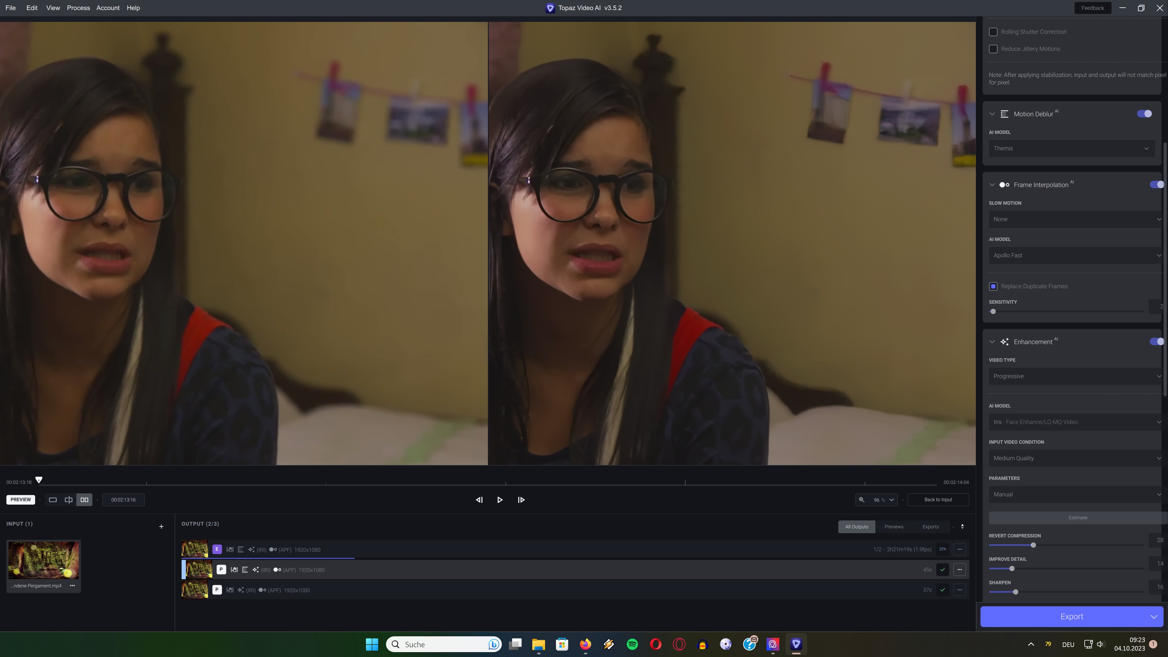

I am noticing that “Motion Deblur” makes hair look strange…
It really looks better without “Motion Deblur”
Tested with Version 3.5.0 & 3.5.2.2.a
With “Motion Deblur”:
Without “Motion Deblur”:

To a certain degree motion deblur does a great improvement, but beyond that it gets worse and worse.
Disabling “Motion Deblur” is not a solution…images loosing a lot of sharpness and overall image quality…“Motion Deblur” helps Iris2 to do it´s job better.
But this thing with the hair should be fixed…
not only with the hair. motion deblur messes up other things too
Motion deblur also removes details to some extent
Is it possible that disabling “Motion Deblur” also disables “Iris2” ?!
I cannot see that “Motion Deblur” is removing details…it´s adding details due to reverting unsharpness in non rapid moving contend.
With Motion Deblur
Without Motion Deblur
There´s no big movement here so “Motion Deblur” shouldn´t have any positive results.
But disabling “Motion Deblur” degrades visual quality a lot.
Try playing with those parameters instead of using Motion deblur
they introduce much less artifacts
start with deblur 60 and sharpening 20 (or 30 deblur and 30 sharpening) . and play around with the values as you test
Deblur 90-100 is very nice…but adding “Motion Deblur” is giving even more…
As i have already sharpen on 16…changing it to 20/30 doesn´t change a thing.
I always used Anti-Alias instead of Deblur there… i will stay now on Deblur 100
