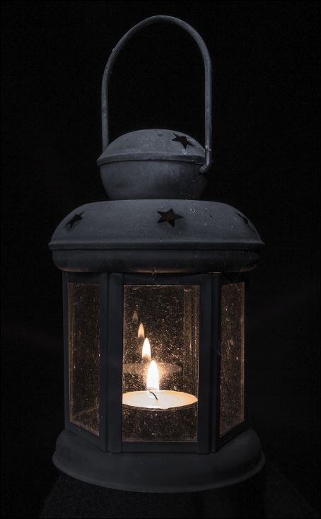

I’m not even using a complex image to mask around. It’s a very straightforward, geometrically clean lantern (for compositing).
Lantern
