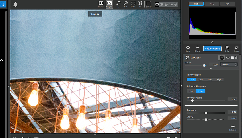

1st image = before AI clear
2nd image = after
3rd = TIFF back in LR
Keep Enhance Sharpness to LOW and I would say set the Remove Noise to Med in this image and that should be OK. Remember that if you enhance sharpness it will enhance the edges of any left-over noise.

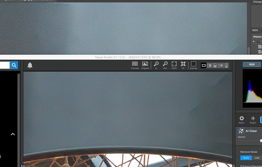

I’m not sure about this. Anything you normally work on you see what you get. I can’t see trying to guess what it may look like back at LR or at what ISO it stops being usable. It is supposed to be AI. I have it set to medium and sharpness low. The upper part is back at LR and AI Clear is below. It should look like it did in when in Topaz Studio. This can’t be right. Unless AI Clear is a light noise correction and sharpening enhancement plug-in.
That’s the bug again - you can see a sort-of super rough pixelated mask to the noise in LR. It’s been mentioned here a couple of times. Happens when invoking AI Clear in Studio from LR. Hopefully fixed soon.

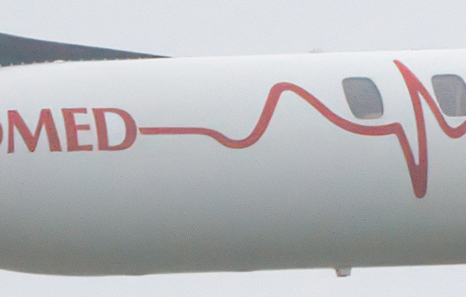

Actually that previous post was a 6,400 ISO file. I tried dragging the 32,000 ISO file I have been posting directly into Topaz and saved as a Jpeg to the desktop. Pattern is still there.
Here is another 6,400 ISO file dragged directly into Topaz. It always looks silky smooth. Exported as a Jpeg. I think it looks a little better than going through LR but still not as smooth as what you see in Topaz. It appears to be more than just an invoke from LR.
top image AI Clear
Original in Topaz

I’ve seen artifacts like this too. I’d would be almost willing to bet money that if you take a 2000 pixel width crop of part of the image into Studio, and process that with AI Clear, you won’t get the artifacts you’re seeing.
How much VRAM does your GPU have?
512MB I’ll try a crop
That is the answer. I found the specs at Topaz. Not good news for me. Guess I’ll bury AI clear for now until I get a new iMac next year which I need to replace. Pays to read the requirements. Thanks for everyones help.
Actually I decided to try my MacBook Air with 1.5GB and 4GB of RAM. Still seeing it unless I crop to 2000 on the long side. It was the least expensive one I could find just for travel. I guess still not enough to handle it.
Even if you meet the recommended requirements I think it would still happen.
When working on larger images with the HD preview enabled Studio still needs to create a sampled (lower resolution) version of the starting image in VRAM to calculate the output for the display preview. This is why the HD preview image appears softer than the actual image.
With AI Clear it appears that the actual final saved output image has had part of its calculations based upon an analysis of the sampled image in VRAM. This could be problematic since the sampled image will show less pixel level noise. The 2000 pixel crop image doesn’t have this issue because it isn’t sampled.
