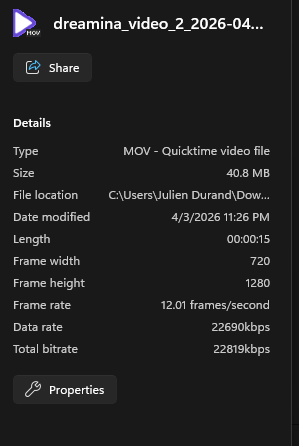

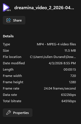

I am trying to interpolate a video from 24.04 fps to 30 fps. The output with Chronos comes out to 12.01 fps. If I chose 50 fps, it comes out to 20 fps.
Same issue if I set Duplicate frames to off.
Before:
After:

It looks like the original could have variable framerate (24.04 fps) and depending how bad the variability is (and the degree of frame duplication), that could cause the problem your seeing.
Without seeing the original first-hand, a complete MediaInfo report might give more insight.
