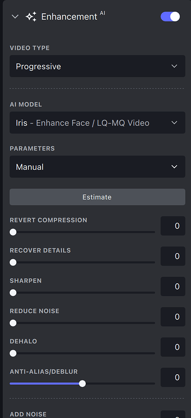

Iris: fine-tune face enhancement
I would like a feature to finetune the face enhancement effect in Iris - because often it appears too heavy to me.

Hi there you can switch to manual when using Iris to achieve this effect :slight_smile:
It sounds like you are looking for a specific setting for the face itself? That would be neat!
That’s my idea
Try with the Recover original details slider and set this really high (>80%).
Really helps with faces getting „generic“.
To still see improvement/sharpening otherwise I‘d also suggest setting Antialias/Deblur to at least +50%.
