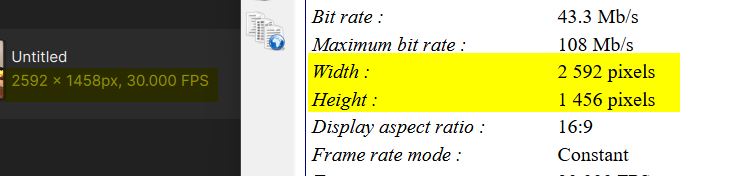

Not a big deal but incomprehensible. If source is 864 x 486 (<- is excatly 16/9) and doing for example 3x, the shown resolution into TVAI is correctly 2592 x 1458, but then the output it does is 2592 x 1456 which is not exactly 16:9, so this makes no sense. TVAI sets a DAR 16:9, means the video gets streched by 2 pixels when play :smirking_face:

left: running output shows correctly 2592 x 1458, right: output what it did is 1456 instead 1458
(2592 / 16 x 9 = 1458)
if this cannot be corrected for whatever reason, at least the resolution displayed in TVAI should correspond to the output

I dont’ have the mpeg-2 orig source it snot a square pixel theme. In generally the question here is why TVAI does resize progressive 864 x 486 source to 2592 x 1456 instead 2592 x 1458
it’s simple math, this is just a sample. Could there be more cases simillar happens?! I just don’t understand why, because numbers are divisible by two, source format is exactly 16:9 and the upscale from source to target size does not generate any floating points.
