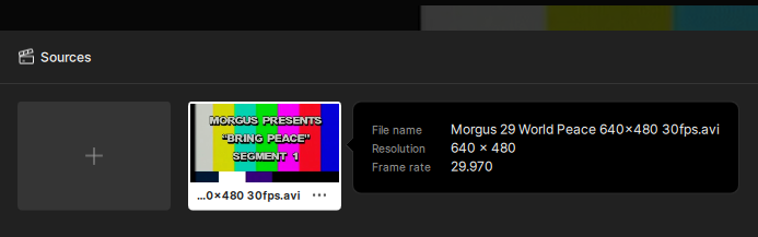

Here are some screenshots, starting with the Sources window with the correct - and only! - file selected.

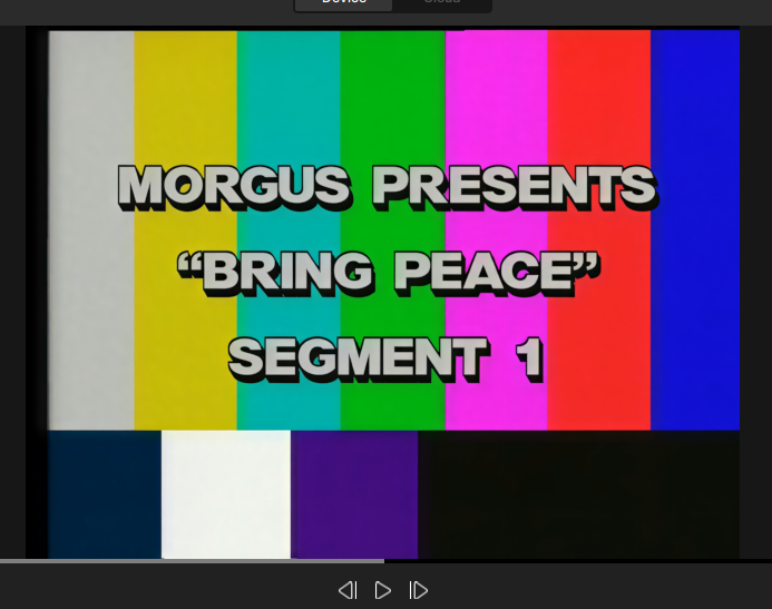

Here’s a shot of the export preview window, showing the same frame.

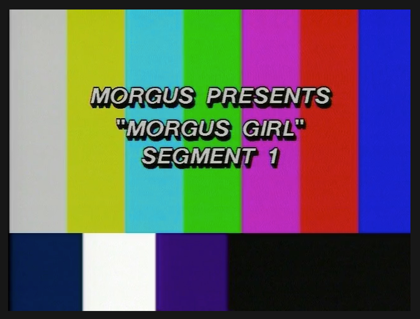

Finally, here’s what the project preview window and timeline now have loaded, somehow…
This is one of the files that I ran a very short test of prior to deleting all of the other source files with the Close all files command, and then adding the file that was to be used for the ‘real thing’ project.
It looks like something wasn’t scrubbed after the Close all files command, which would be a housekeeping issue of some kind, I’d think. Not reporting ‘bug’, per se, but it is very strange.

Update. Although the issue was real, I don’t think it’s necessarily worth the team’s time pursuing the wild geese.
After the render finished, I closed the project and the app, then restarted Topaz Video and reopened the project. The correct video now appears on the timeline. There was a system restart and some other playing around, too, but I’d guess some internal record-keeping had been incompletely updated or something.
Understood, Chuck. I will keep an eye out if we see the situation continue or pop up again for a further look into it.
