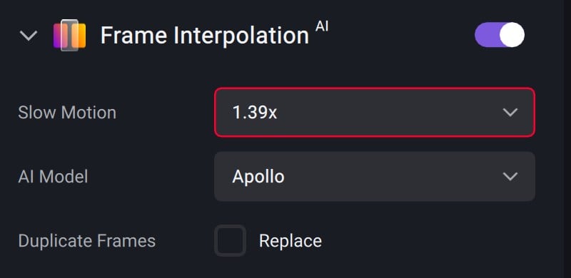

Unfortunately, this does not work with my version 4.0.9.
A red frame appears after and the preview is executed as “None”.
2024-01-03_11h52_29
Any ideas?
