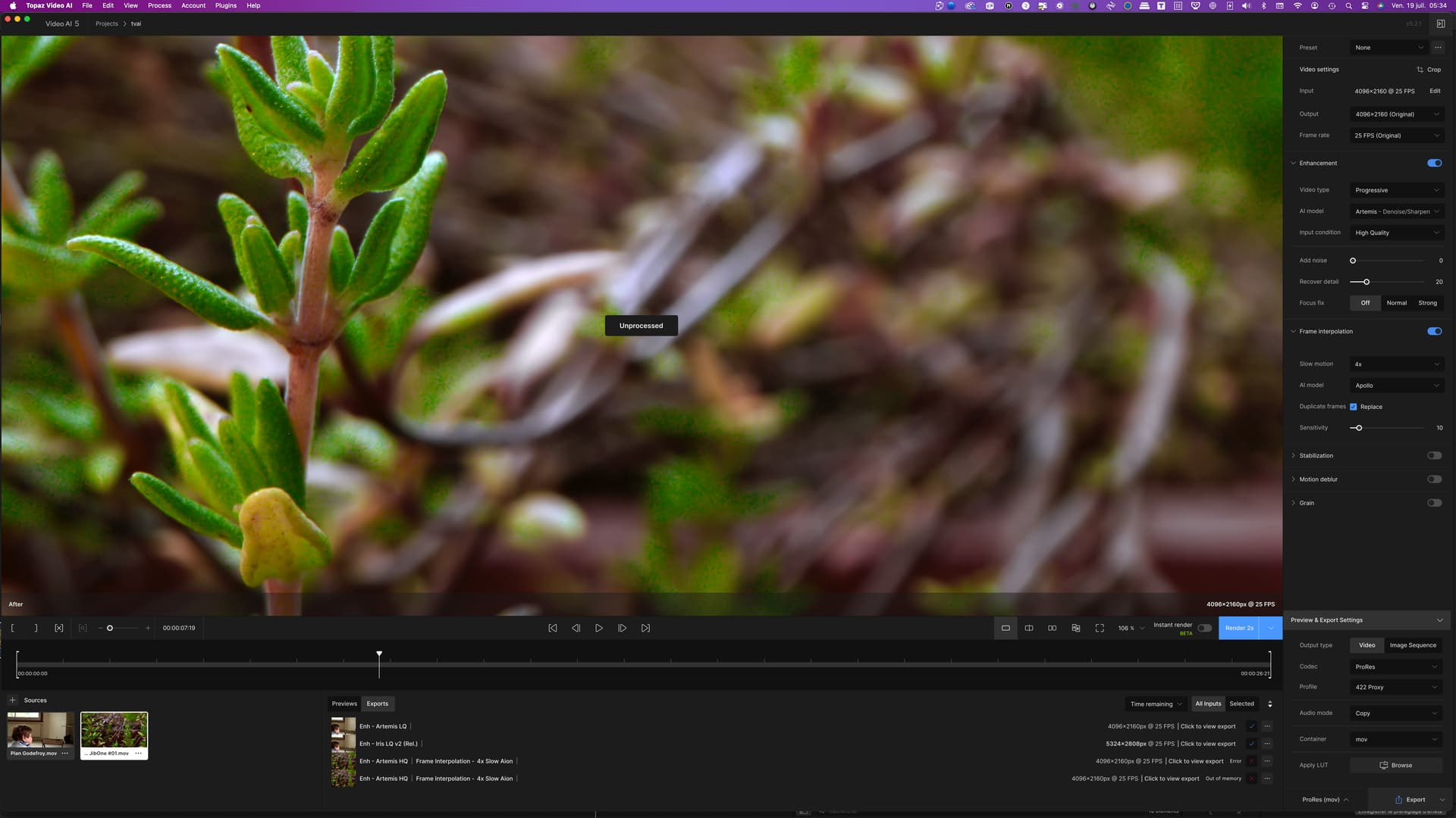

Impossible to render
    I have an error when I want to Enhance (Artemis Denoise Sharpen size original) + Frame interpolation (Slow motion x4 Aion)

It’s only with one clip.
Artemis run perfectly.
Aion crash the computer.
Here the log with just Aion (three logs from today 04:41-49-56
