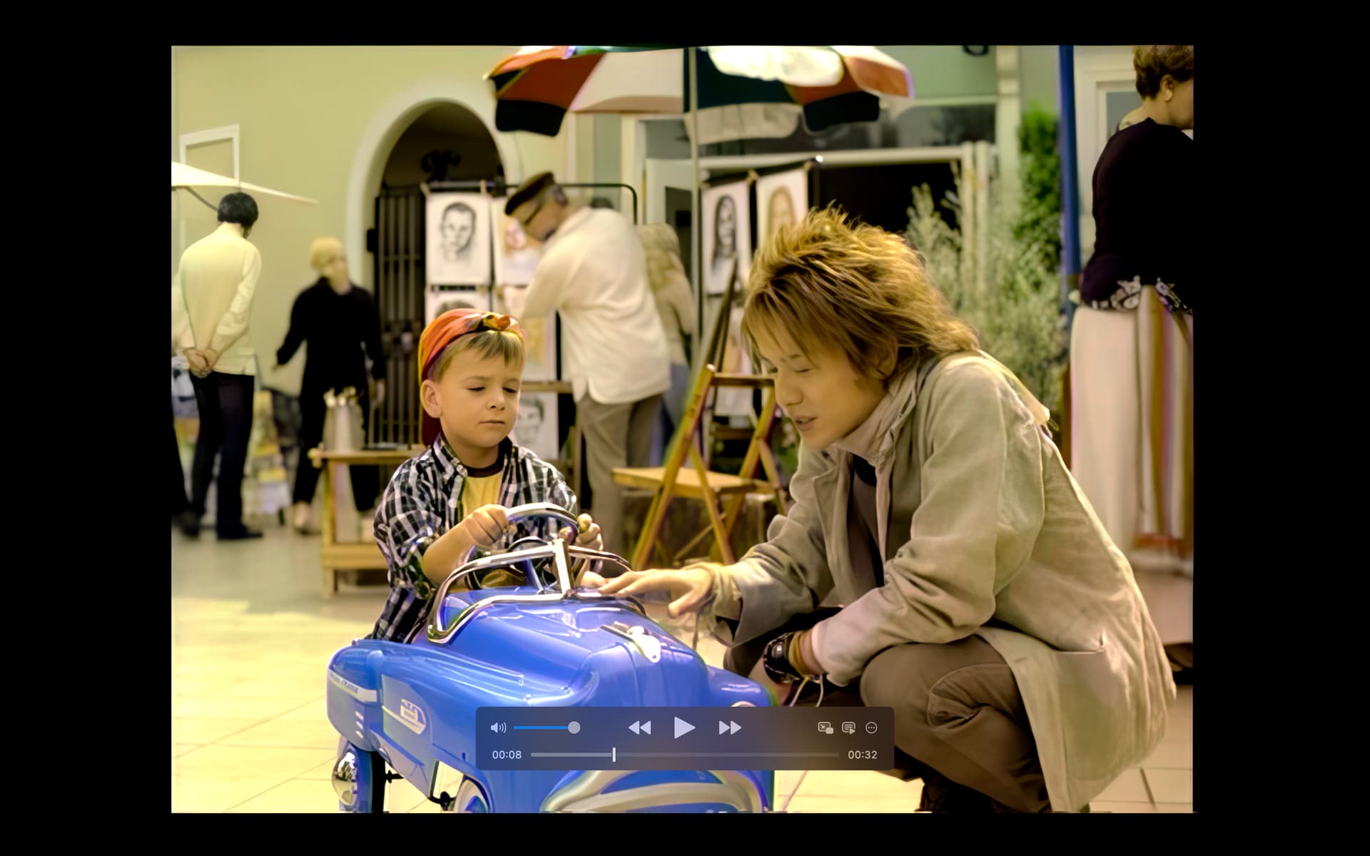

It’s great that you implemented SDR/HDR conversion in the program.
Unfortunately my monitor doesn’t support HDR. And whichever player I try, I get different colors.
MPC-HC
MPV
Potplayer
Google photos web player

Quite a few video players (and image viewers) are not yet able to display HDR content. They cannot even tone map it to display correctly on an SDR monitor.
I am using JRiver Media Center with madVR to passthrough HDR directly to an HDR capable monitor, bypassing the SDR Windows desktop. This setup can also tone map HDR video to display correctly on the Windows desktop in SDR on an SDR monitor. Added bonus, it plays back all video, SDR and HDR fully calibrated to the current monitor mode/profile at the correct frame rate.
As for picture viewers, ImageGlass can tone map HDR images to SDR but cannot display them properly in HDR. I use Affinity Photo to view HDR static images in HDR at this time (slow and clunky, but works).
Hopefully this information will help you serviceably view HDR content on your SDR monitor, but without an HDR pipeline and monitor it is not really possible to evaluate this new feature being added to Video AI.

as mentioned above, most video players can´t handle high bit depth playback or interpret the embedded HDR Data or even tonemap everything.
Try VLC for a quick and dirty solution.
MPC-HC needs some tweaking.
