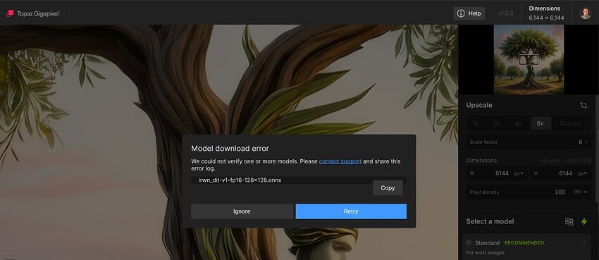

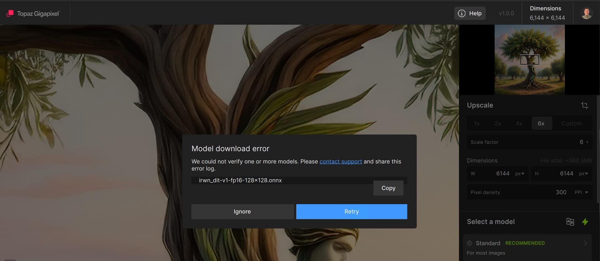

Getting the following messages when using the new Gigapixel:
followed by:
Nothing seems to be downloading from what I can tell.

FYI - I picked the Ignore option, and the Gigapixel appears to be working as expected. yeah!

Well, I’ve installed the new version on two of my machines, both running on the same network and same configuration. This only seems to be happening on the one machine, which has a GPU. I would expect if it were Firewall or Ad Blocker related, I would expect to see the same systems on both machines. I did compare the models listed at C:\ProgramData\Topaz Labs LLC\Topaz Gigapixel\models from both machines. My main machine (non-GPU) doesn’t even have that model (irwn_dit-v1-fp16-128x128.onnx) listed. There are no irwn_dit-v1-fp16* listed at all. I will try and review where it might be blocked, but both machines are on the same network, same os versions and same rules. I’ll let you know how I fair in finding a cause.
NOTE:
I think I have it fixed… I backed up all the irwn_dit-v1-fp16* first, then I replaced them with the same named models on the Gigapixel AI Beta. I no longer get any errors, and processing seems to be working fine.

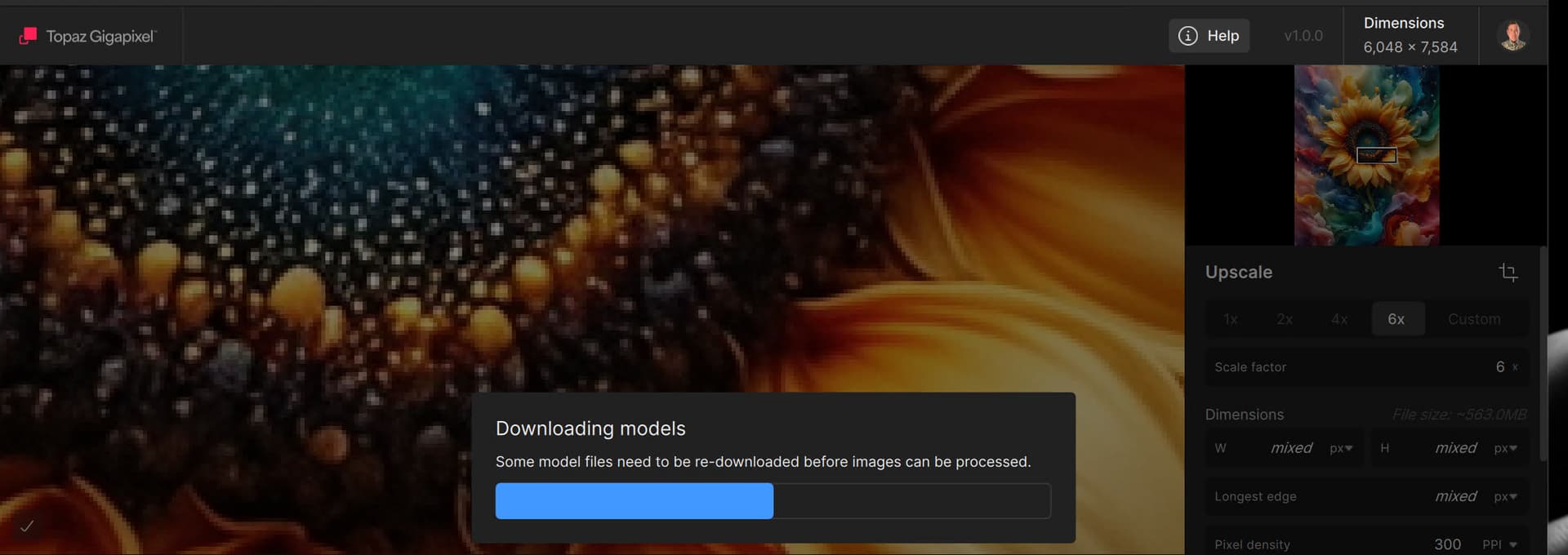

I keep getting the dreaded blue bar, it moves pretty quick but when it gets to the end, just freezes. I close the screen and got these error codes about downloading models.
irwn_dit-v1-fp32-128x128
gfrf-v2-fp16-1024x1024-ov

Downoload of this component is not possible for me. Download stops.
Review troubleshooting for model download errors
Just installed latest version. Tried to open an image - says models need to be re-downloaded but app freezes without doing anything.
