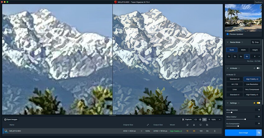

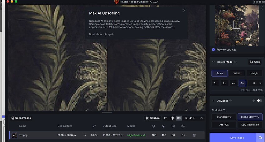

I just tried downloading at 6x and it came out completely pixilated.
Hi Kate, please clarify what’s going on.
What is “downloading”? Loading the image into Gigapixel?
I see you’re not trying to exceed 6X, not sure why you’re getting the error.
Here my attempt to upscale an iPhone photo 6X also on Mac (M2), no problem.
