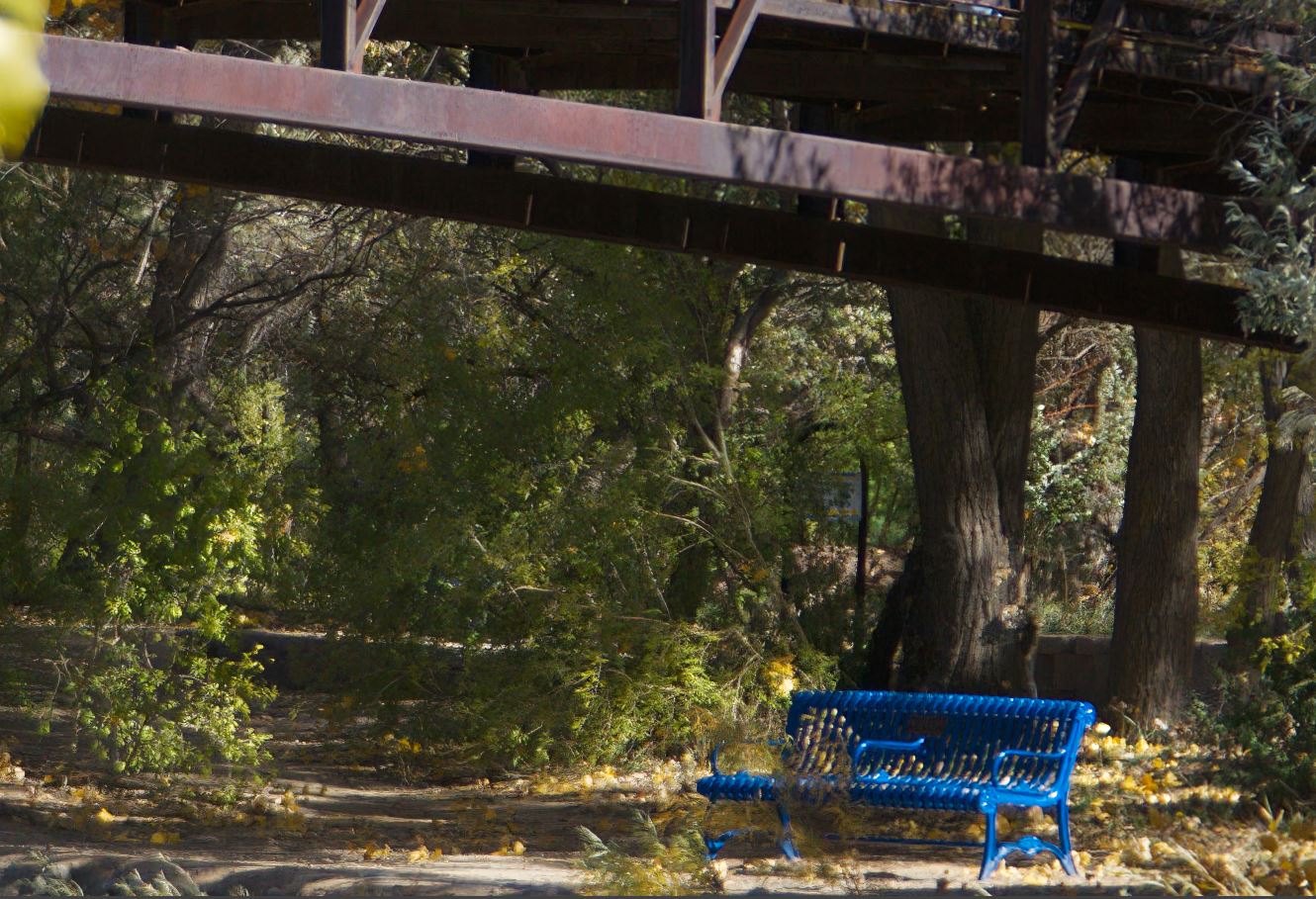

I have an AMD Ryzen CPU, Windows 10 PC and a AMD Radeon RX580 GPU so I didn’t try the Intel optimization. I did run a test of version 4.3.1 vs 4.4.0 using a 2272 x 1074 pixel picture so it could be compared to those above.
I found that running my browser open (25 tabs) greatly affected the results. Browser open, the 2X scaling was 64 seconds and when closed it dropped to 17 seconds. I have 32 Gb of fast RAM so I don’t think this was a problem. I didn’t test it again so I don’t know if this was a fluke.
Settings were 0.50 for blur and noise, GPU memory (4GB) = high, 2X scaling, Face refine= off.
V4.3.1: time was 17 seconds for max quality and 9 seconds for Max quality = off
V4.4.0: time was 16 seconds for max quality and 8 seconds for max quality = off
I opened each result picture (Quality max vs norm) from 4.4.0 in Affinity Photo and compared them (see below) at 100%. They looked identical.
Max quality = no:
Max Quality = yes
