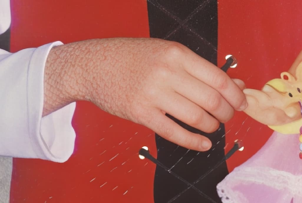

Hello almost every hand or neck, decolt its in Gigapixel AI (latest) recover v2 with faces recover gen1(gen2 is worse changing faces).
Detail in 50
Face Recover 50
Soon I’ll send via form.
