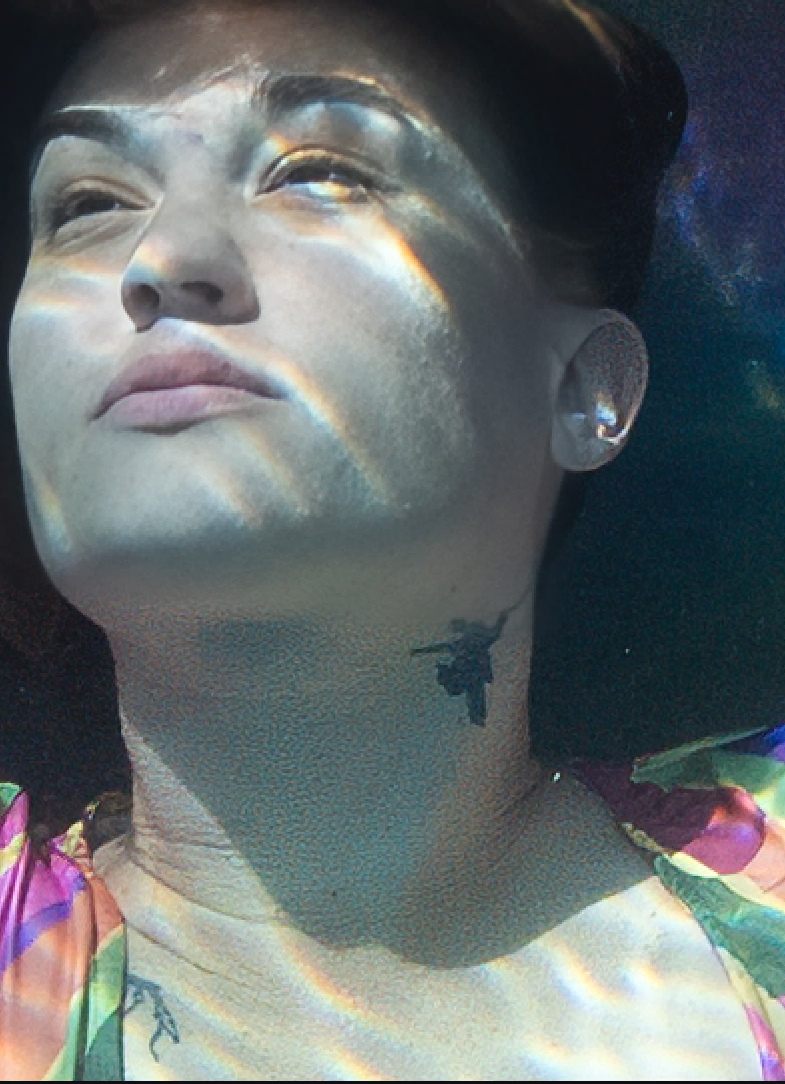

I am attaching a couple screen shots. This is an underwater image, I do a lot of underwater models. I run the raw image through PAI before I start any editing on it. It helps to give a cleaner bases, usually. But this face recovery has been through all iterations, unusable for me. You can clearly see the delineation between face and neck, and the ear. Also, the noise that is introduced through sharpening on the neck and skin and shadows isn’t good. If you continue with face recovery, make it skin recovery, not just one body part, Don’t limit it, but have AI find the skin. I can do that in LR and PS. Thank you. I do use PAI for everything. It seems it was better in some previous version and the more you add to it, the more noise and roughness is being introduced.
You may want to try DxO PureRaw, I find that pretty good at giving clean images, it is just a Raw processor. It also has lens correction.
I do a lot of long exposures, which tend to be noisy, it does a good job on those, at removing noise. I find Topaz blurs noise rather than remove it.
You can try it for 30 days free.
The problem with noise, if you add sharpening, it will make it worse.
Underwater is a bit tricky with the distortion and lighting.
