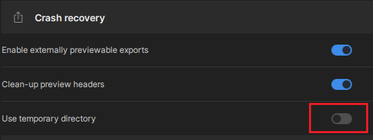

I like to export my my videos and see the “temp” file at the original source directory instead of it being placed in temp directory 1st, before the copy of the final rendered video to the source file Dir…
It could be that this bug happens only if you do not use Temp dir.
