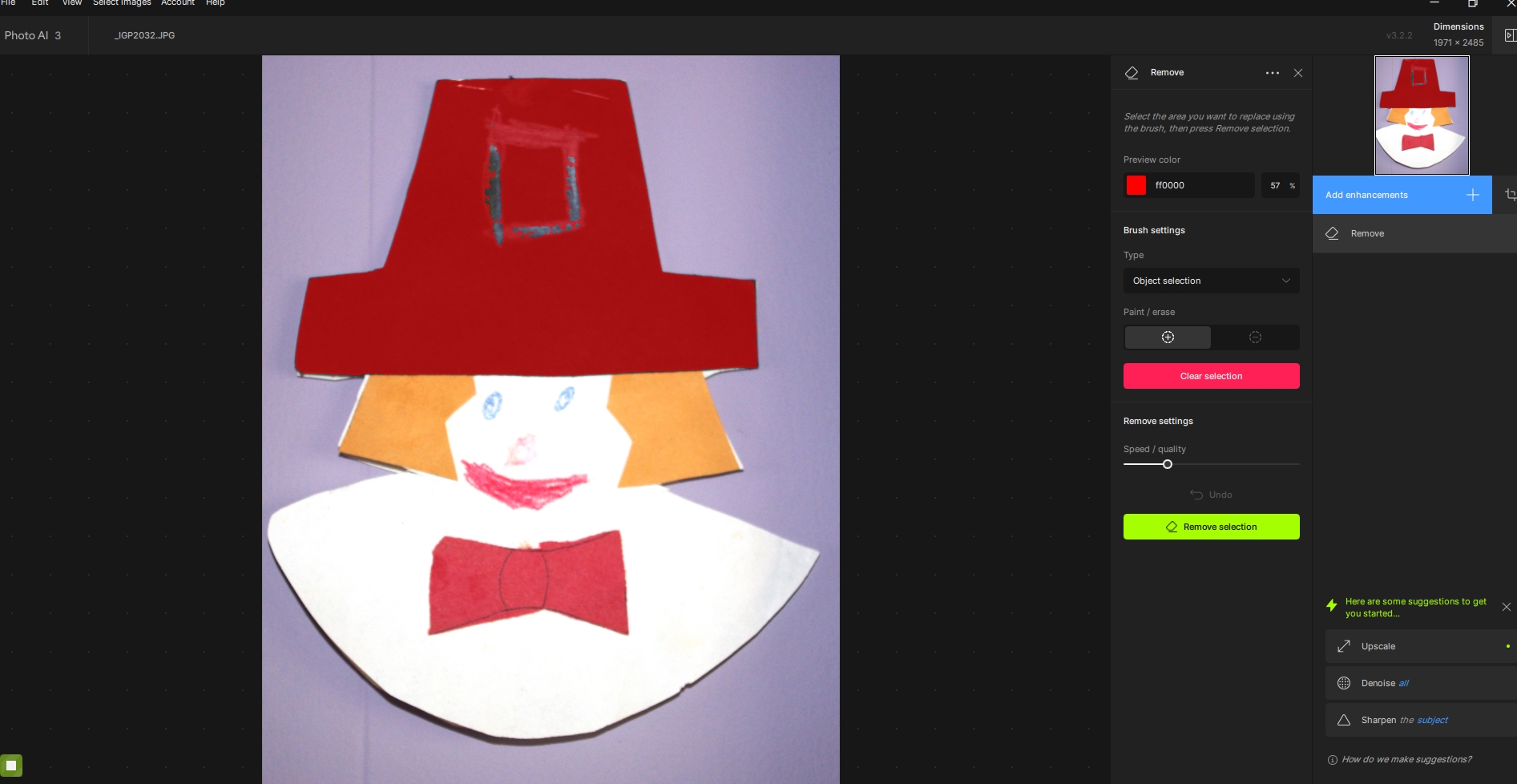

Steps to reproduce issue:
1.Load Photo (Windows 10 Pro
2. Select hat, using object removal brush (see screen shot)
3. Removed hat, or rather, created a new hat out of this air…?
4. Press undo selection, and then select ALL components of hat. Press remove.
5. Process runs along, crashes about when “removing objects…” button in lower left corner reaches the first ellipse dot…
Topaz Photo AI 3.3.0 (also on previous two update version – did not occur before then), running Window 10 Pro

I hope you don’t mind but I took the liberty of downloading your picture and replicated yours steps to see if I got the same crashes but I didn’t. The only difference I made in the original picture was to mask all the hat.
Windows 11, Home using Photo AI 3.3.0 Standalone.
I did three passes with the remove tool with different masking for each picture to remove the different hats that were created on each pass (Which I didn’t think was possible. So I’ve learnt something new) I’ve screen grabbed the results.

Hello @edward.ellickson - This is a community forum, for which other users can give their input, for which @myhuskymax and @robert.bingham kindly have done and showed their results :slight_smile:
Looking at crash reports for your machine on our side, Remove Tool will not work correctly on your machine as you have a AMD graphic card with only 0.5GB of VRAM, when the minimum needed to meet the minimum requirements for Photo AI is to have a lot more, 6GB of VRAM (8GB recommended). The selection of the hat is also very big, and the tool mentions not to select areas that are more then 25% of the picture. The intended use of this tool is to remove let’s say, people on the beach behind your subject, a trash can that ruins a picture, etc, not changing a hat on a person.
Until you can get a computer that meets the minimum requirements, the most memory intensive will cause issues on this machine. You can test, in the meantime, to force Photo AI to use your RAM: Edit > Preferences > General > AI Processor to CPU.
