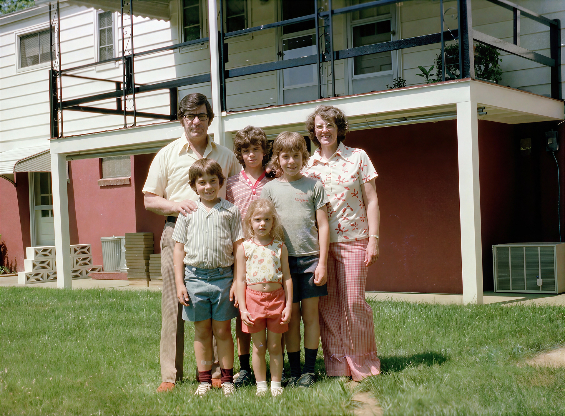

I have some old 110 film strips that were scanned by a professional scanning service. The camera used was an old crap Instamatic from the 1980s. The combination of a lousy camera plus 110 size film plus scanning means that the digital versions I have are very blurry.
I know there is a limit to how much can be done, even with the generative models, but I am having trouble finding a decent model in Topaz. I’ve tried Wonder 3, Low-res, Recovery 2 (with predownscaling), and Recovery 3.
Recovery 2 is the only one that makes a substantial difference; the others improve the blurriness very slightly, but not enough to consider the result acceptable. The problem, of course, with Recovery 2 is that it produces noticeable artifacts (such as smeary areas), and faces are so clear that they look artificial.
Are there any ideas out there about how to get an acceptable result?

Seems trying to send a >50MB zip file choked the forum. Two smaller zip files did the trick.
110 images-1.zip (29.7 MB)
110 images-2.zip (25.2 MB)
Did you do anything to these TIFF? Are you scanning directly to TIFF? I will test those images tomorrow. Others might have results sooner :slight_smile:
The TIFF scans are the direct output from Nikon Coolscan scanner the scanning service used.

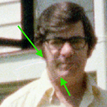

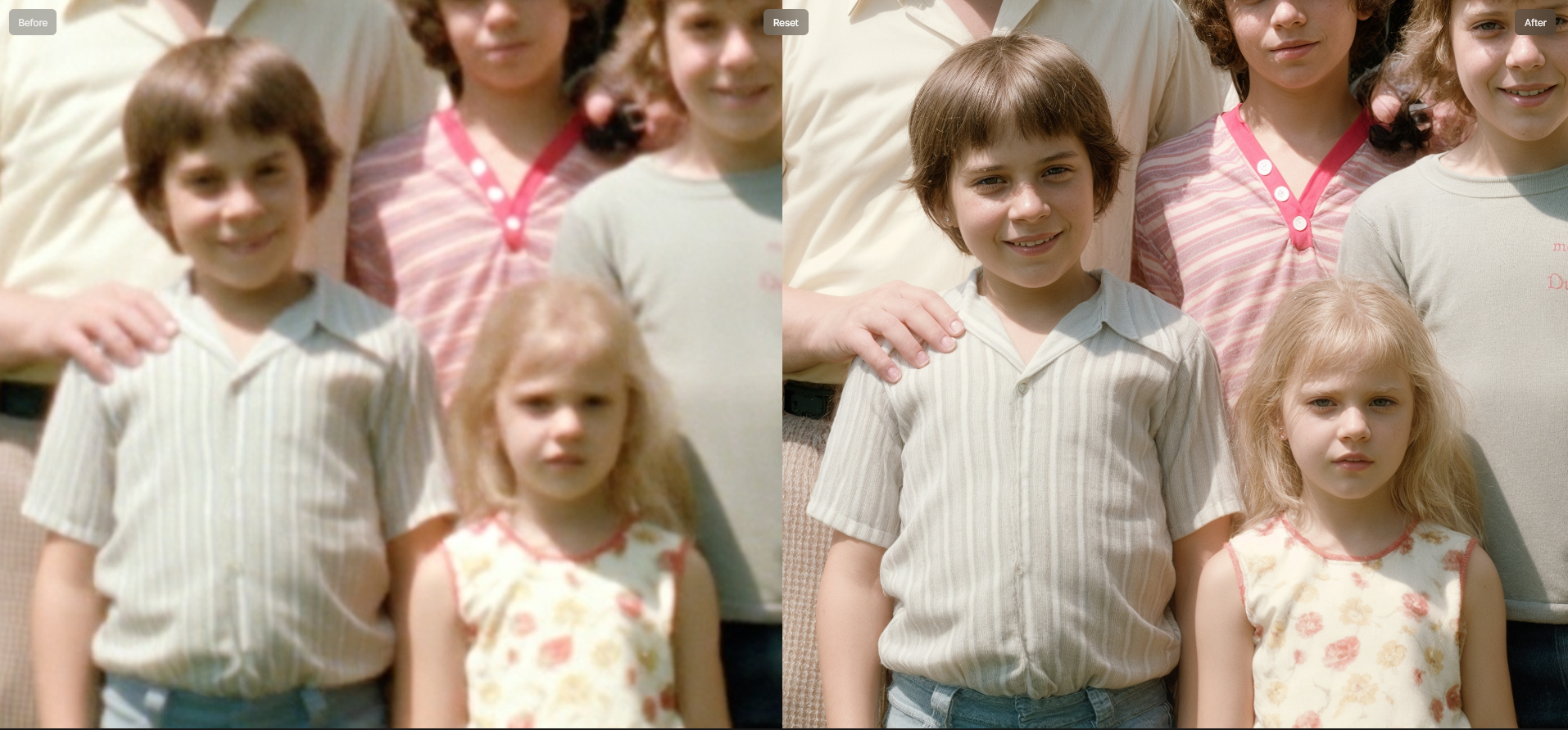

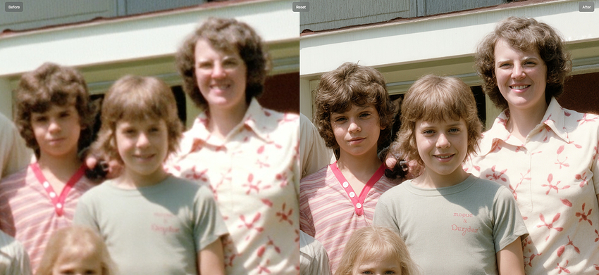

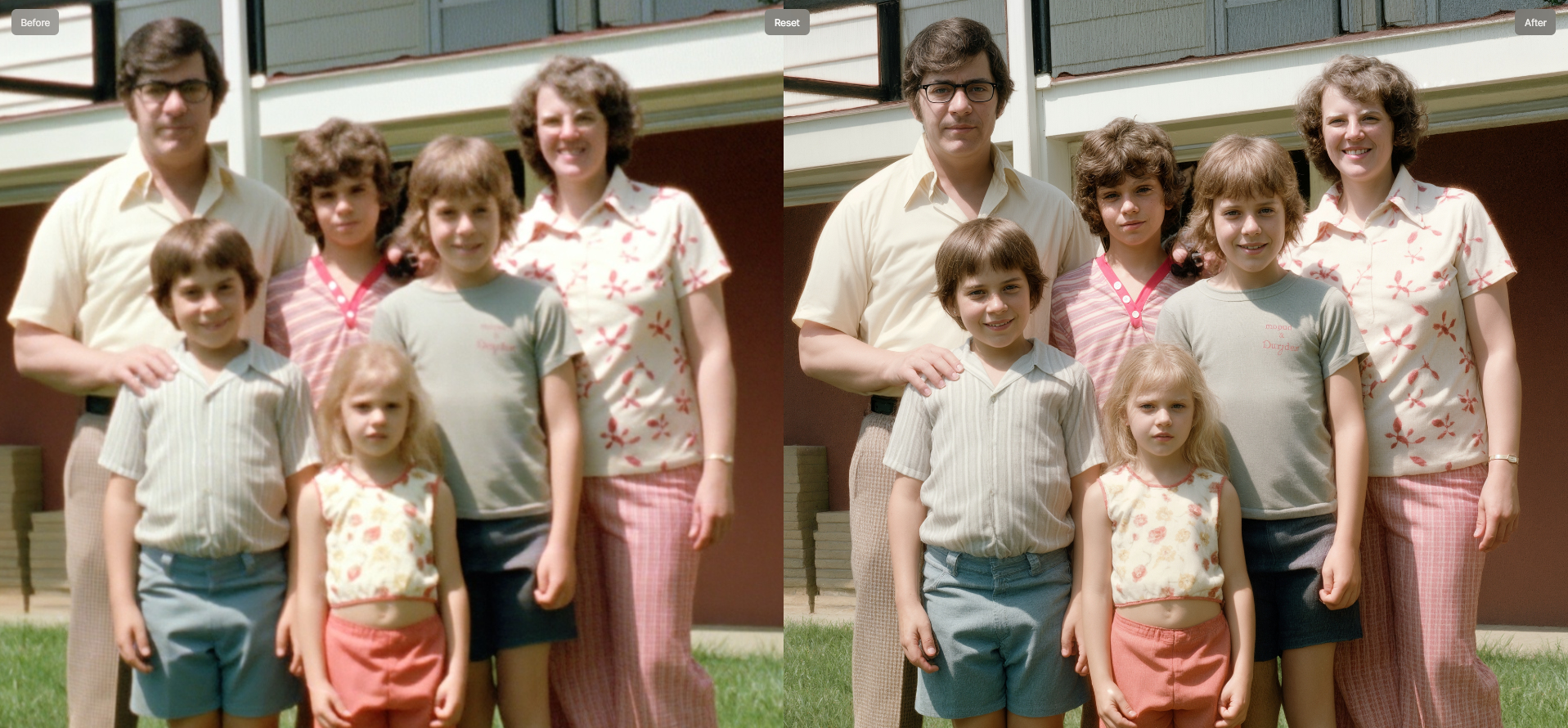

Because I know you have Topaz Photo and Topaz Gigapixel, I did a workflow with the two
  1. Import in Topaz Photo
  2. Add dust and scratch, and use the spot healing tool to remove imperfections and remaining scratches (I did only the one on the man’s face)
  3. Export (I exported as JPEG as it’s easier to manipulate after)
  4. Import the JPEG in Topaz Gigapixel
  5. Select 4x as the scale
  6. Select Redefine Realistic - Subtle for the model

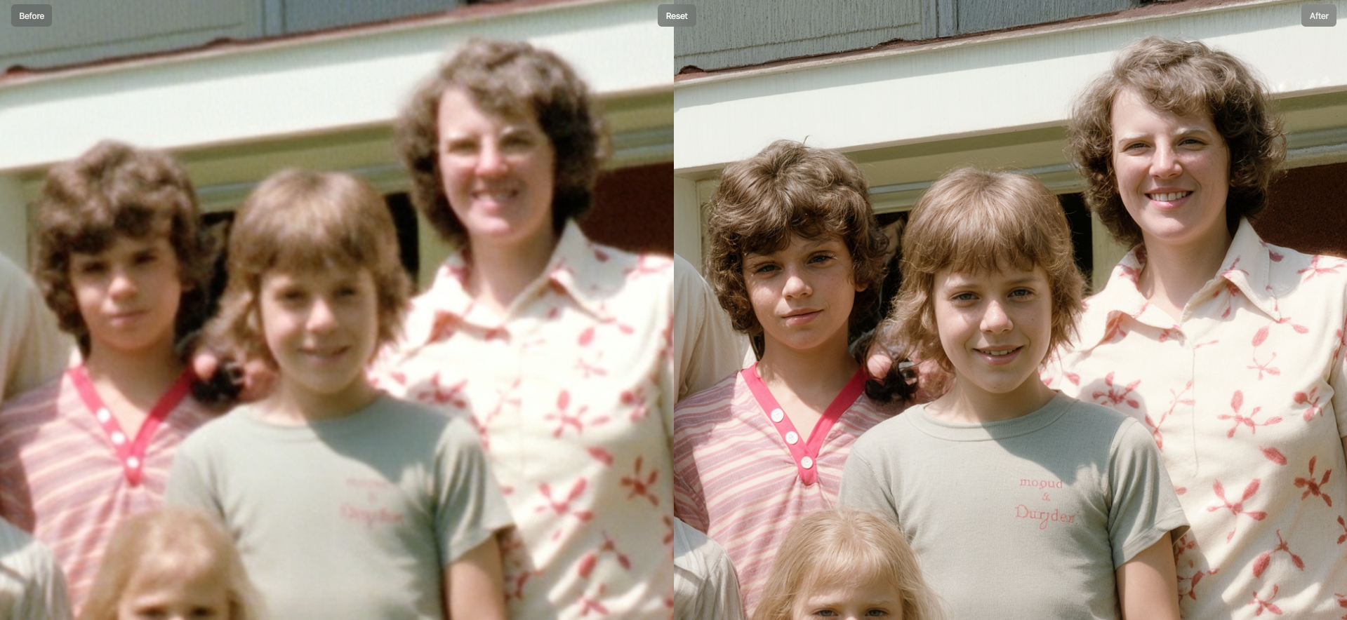

Compare link if you want to inspect the file.
It’s not perfect, and the faces might be changed a little bit, but considering the lack of details on the subject I think it’s good. I wasn’t able to get the glasses on the woman on the right, the AI removes them

Why did you choose Redefine-Realistic vs Recovery?
One of the things that I find difficult is to choose among the large number of models that topaz provides. Whether I use local processing (I have an M4 Studio Max) or cloud processing, it takes too long to try multiple models and multiple settings with each model in order to see which combination seems to produce the best result. While there are some general guideline (e.g. it would be stupid to use High Fidelity on this image!), for any given image there seem to be multiple possibilities that are reasonable.

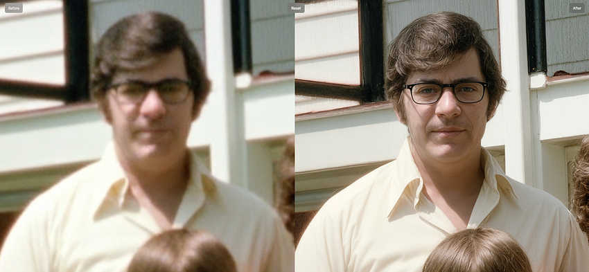

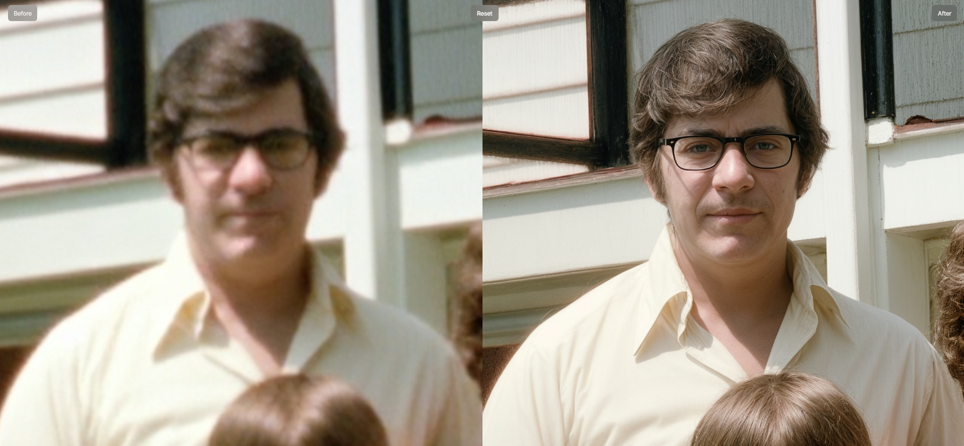

Typically with scanning, over-scanning will occur in an effort to make a larger digital image; but this often introduces false resolution. In all of the examples below, some form of downscaling was applied to condense image detail before or between processes.
Downscale to 1024px > 4x Wonder 3
1x Recover 2 + Recover Faces 3 > Downscale to 1024px > 4x Wonder 3
1x Standard Max + Recover Faces 3 > Downscale to 1024px > 2x Redefine realistic + Recover Faces 3 > Downscale to 1024px > 4x Wonder 3
Applying multiple steps of processing and downscaling can help with restoration in different ways.
One more that is similar to the others.
1x Standard Max + Recover Faces 3 > Downscale to 1024px > Wonder 3
I usually manually downscale whenever I want to condense image detail.
1x of Standard Max, Recover 2, or Redefine realistic can help act as a noise reduction pass and a clean up for dust and scratches. But each can tweak the faces in undesireable ways, so I tend to enable Face Recovery if needed.
Wonder 2 or 3 is the best final upscale step for accuracy. If you’re comfortable with compositing, doing an additional process with Redefine realistic Subtle or Redefine creative Low will give nice environment and background details you can brush in with layers in your editor of choice.
As you can see, different people have slightly different workflow and results. Our models are not universal for a specific task, and this is why it’s important to try a few different ones on restoration like this. With cloud rendering, I usually send the file with all the generative models simultaneously. I can then later compare the different outputs, and if needed tweak the settings on that specific model and send again to the cloud later.
I chose Redefine Realistic in this case as it gave me the best results for the clothing, and for the faces. It recreated the textures accurately. My next step on this image would be to blur the background and de-saturate slightly to hide the issues there. We want the focus to be on the people.
